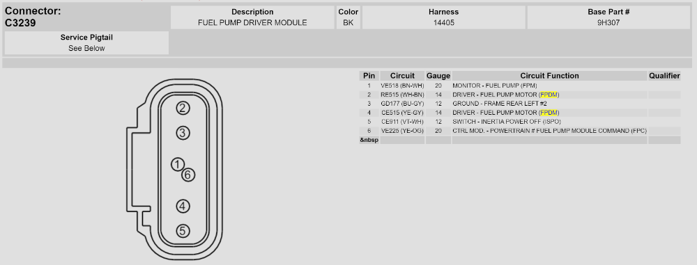

Artstu, do you recall if any fault codes set during the stall? I figure with the FPM circuit showing 0%, or the fuel pressure not meeting desired, one fault or another would have shown up.
You said you can reproduce this in your driveway, right? In that case, I think I'd try jumping power and ground to the pump at the FPDM connector and seeing if the loss of fuel pressure reoccurs. If it does, the FPDM and the control circuits aren't the problem.
I don't recall if it's possible with this exact FPDM connector (WPT-903), but on some, you can simply use an ATM or Micro2 fuse across pin #2 + #3 and #4 +#5.

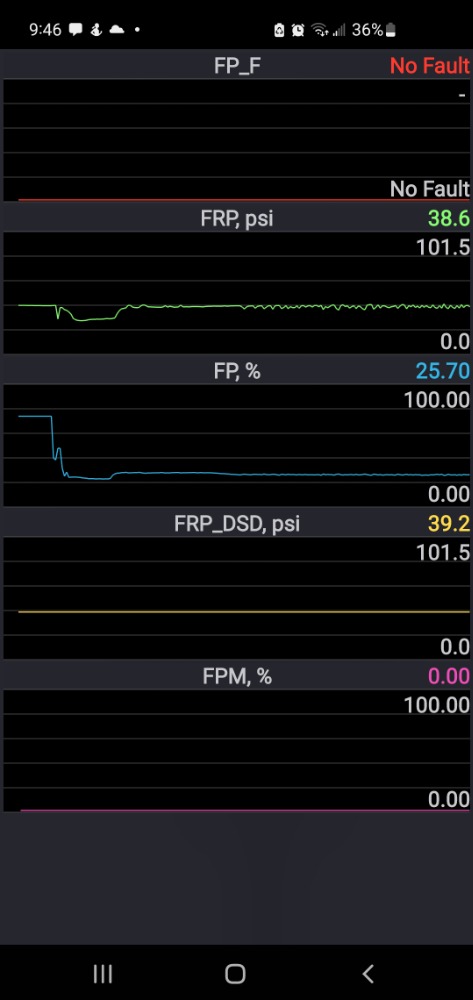

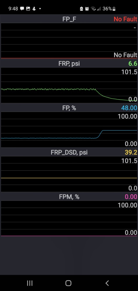

2 years 6 months ago #65288 by Artstu
Replied by Artstu on topic 2008 F250 6.8 FPDM
Cleared and pulled the codes again after experiencing the drop in fuel supply. Didn't get a chance to confirm duty cycle on the monitor circuit.
P1233
P0191
From what I have read if I had a problem with the fuel pump or the wiring I would have a p1237.
attached a couple screenshots of what is going on one from initial starting, one when it cuts out. Durring both these situations I have confirmed that the control duty cycle is correct at the pcm plug and at the fpcm plug, both reading desired duty cycle plus or minus 1-2% at 150 hz and while everything is working I have 50% on the monitor pin.

2 years 6 months ago #65305 by Artstu
Quick update. I ran dedicated 10 awg from the battery ground and power to the fpdm pins 3 and 5. Confirmed control circuit, matches ecu demand, monitor circuit has 50% while running, goes straight to 0%, 14v when it shuts down.
This is happening on both the brand new dorman part and the brand new motorcraft part. At a bit of a loss here, everything I have read still points to a bad fpdm, but I am leaning towards just putting in a new pump to rule that out. Not a fan of just changing everthing till it works.
