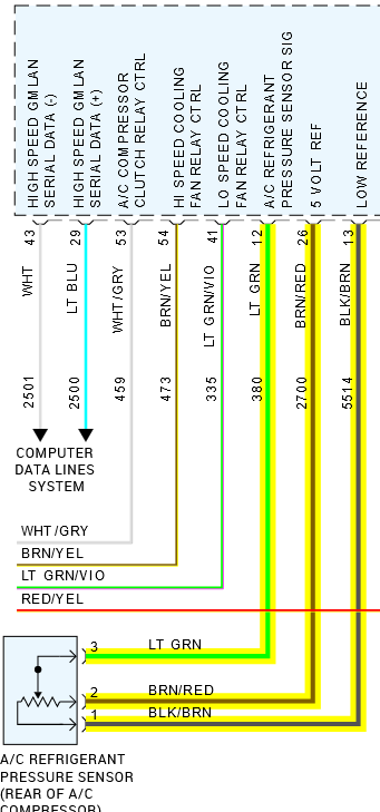

All of my troubleshooting has pointed me to the refrigerant pressure sensor. For brevity's sake I'll leave out the details of everything I tested to get there, unless anyone is curious. At 65°F ambient, with the car having not been run recently, the static pressures measured low-side 72 psi and high-side 77 psi. This pressure should be within the range to allow the compressor to be engaged (32-450 psi on high-side), so I started checking the pressure sensor. Diagram is attached for reference.
With sensor connector mated to sensor and X1 demated from ECM, I measured 11.53 kΩ from 26 to 13, and 6.82 kΩ from 12 to 13. (I also verified wire integrity, no shorts to chassis, etc; again, details if you're interested). I applied 5.00 V across +26/–13 with my own power supply, and I measured 0.974 V across +12/–13. Given those resistances I measured I would have expected 2.958 V (=5*6.82/11.53). I also measured 6 mA total current, where I would have expected 0.434 mA (=5/11.53k). I can't explain the voltage or current measurements.
Issue: A/C compressor is not being commanded on
- Does anyone have a volts-to-pressure chart for this sensor? I can't find one, but I suspect 0.974 V might be less than 32 psi.
- Is there anything wrong with my methodology? Measuring resistances, applying external voltage, comparing voltages and currents to expected values - are those meaningful tests?
- Is there anything different about the way the ECM applies 5V versus the way I did?
Last edit: 2 years 6 months ago by aluiaam. Reason: Text-based "diagram" did not come out looking correct. Attaching a picture instead.

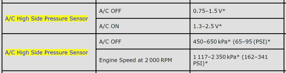

Hey aluiaam! I couldn't find a pressure/voltage chart in service info, but I did find this bit in the scan tool data parameters chart:
According to this, it would seem that your voltage reading of .974V should be sufficient to allow compressor engagement.
I wouldn't say that there's anything wrong with your testing or methodology, necessarily. Thorough, certainly! But maybe a bit indirect, or possibly unnecessary.
I mean no offense here, but is there a reason you didn't want to do voltage readings at the A/C pressure sensor with the engine running and the A/C requested on? Or, was there a reason you didn't trust the 5V regulator in the ECM?
Not that I can see. The only difference I can think of between your setup and the vehicle would be that the ECM may employ a bias voltage on the pressure sensor signal line, which may result in a difference in circuit behavior.
As far as your inoperative A/C goes, I think your next best bet is a scan tool. GM typically provides excellent scan data regarding A/C operation. You'll be able to see the pressure sensor signal, plus the A/C compressor clutch relay command AND the A/C request from the HVAC controller. Between those three PIDs, you should get a pretty good idea of where the problem lies.

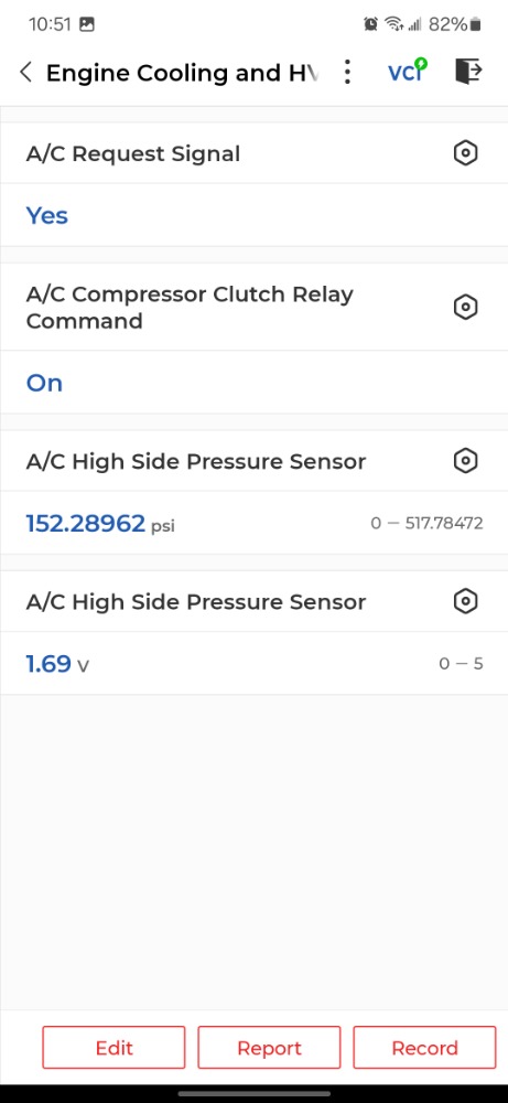

Can you recommend a scan tool that will read those HVAC PIDs? Bidirectional commanding for compressor clutch would be nice to have too. I have an Innova 5210. It reads 42 PIDs in total, but no HVAC PIDs (AC pressure, evaporator temp, etc).

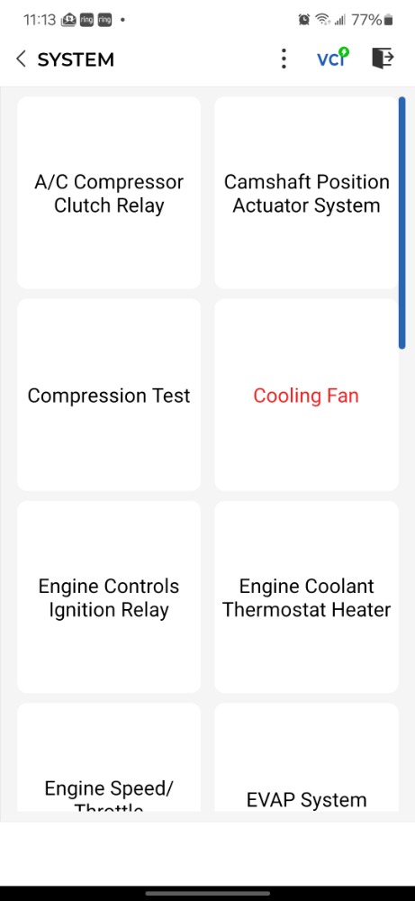

As for a scan tool, it's tough go to wrong with the TopDon TopScan:
www.topdon.us/collections/service-tools/products/topscan
The TopDon (Launch) coverage for GM vehicle is usually excellent. HVAC scan data and bidirectional controls will be there, as well. As long as you have a smartphone, it's an incredible value at $60. Paul even used it in a recent Premium video:
