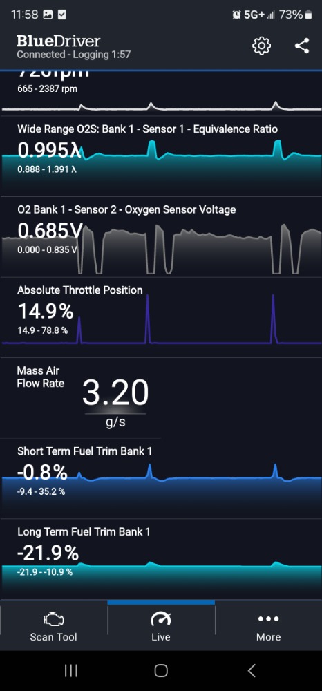

Here is a screen shot at idle. You can see what happens the 3 times I pressed the accelerator:

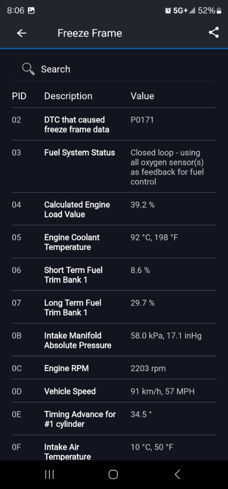

Here's a freeze of when it threw the P0171:

The screenshots are very much appreciated.
Given the Freeze Frame and the data shot you posted, I think you're ready for an OEM MAF. The fact that it's overreporting at idle and (likely) underreporting under load is classic failed MAF behavior.
Technically, low fuel pressure/volume could also be suspect with lean trims under load. But, that doesn't account for the overreporting and rich trims at idle. Plus, checking fuel pressure on a Suby is a pain. I've also seen rare cases where a damaged/missing air filter was causing skewed airflow across the MAF. In these cases, the filter is obviously installed incorrectly or deformed. If you're in doubt, change it with the MAF.
If you wanted that 110% confidence, you could aways look at peak Absolute Load and peak MAF during a wide open throttle run through 1st and 2nd gear. I don't have known good values for this engine off the top of my head, but I'd expect 90% or more Absolute Load.

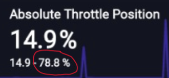

Those values are terrible.     I still say go for an OEM MAF. Nothing wrong with the data you're gathering with the BlueDriver, either. As for peak MAF, I mostly just meant the highest value you'd see. I think the BlueDriver software will record that automatically in graphing mode:
