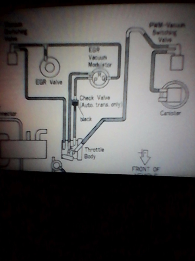

(fixed) 97 toy tacoma 2.4L p0401 was created by gilbert
I have this 97 tacoma with a p0401 i apply vacuum to the egr truck stalls so egr is good. I also applied vacuum to the vsv valve and air was leaking slowly so i replaced it. The next day light back on same code this time i took the intake off cleaned all ports dirty but not plugged. At this time i also put a new vacuum modulator. The next day again light back on same code don't know what is next please help.
Thank you all for your help God bless.

9 years 3 months ago #11261 by gilbert
Replied by gilbert on topic Re:97 toy tacoma 2.4L p0401
God bless you my brother's and sister's.
Hey Tyler thank you for your help I just put a diagram of the EGR system hope this help.

9 years 3 months ago #11278 by Tyler
Replied by Tyler on topic Re:97 toy tacoma 2.4L p0401
Sorry gilbert, I hadn't seen that you've replaced the vacuum transducer already, my bad. :blush:
With the VSV activated, do you get any vacuum at the EGR valve? These use some kind of goofy restrictor in the hose, so it won't be manifold vacuum. Around 8" would be good.

9 years 3 months ago #11282 by gilbert
Hey brother i checked the egr valve for vacuum and it doesn't get any at any time. I checked the valve for vacuum at the Q line and activated the vsv valve and nothing. I T'ed from the Q and the vsv valve and activated the valve and nothing. Then straight too the egr valve and nothing the only line that has any vacuum is the R line.
9 years 3 months ago #11285 by matt.white
Replied by matt.white on topic Re:97 toy tacoma 2.4L p0401
It's not the check valve stuck is it? Or is the P line on the filter side of the throttle plate. Sorry, I've only got the diagram to go by.

9 years 3 months ago #11350 by Tyler
You may need to raise the engine speed while you activate the VSV, because of the way the vacuum transducer works. It gets exhaust pressure on the bottom, which moves a diaphragm and controls vacuum to the EGR. If there's not enough backpressure, then it won't flow vacuum.
Speaking of, another place to check is the hose coming off the exhaust, to the vacuum transducer. I've frequently seen carbon buildup in the pipe going to the vacuum transducer, which causes the transducer to never open. You can test for this by pulling the exhaust hose off the transducer and starting the engine, looking for exhaust flow.

9 years 3 months ago #11497 by gilbert
Replied by gilbert on topic Re:(FIXED)97 toy tacoma 2.4L p0401
The fix for this was blowing air through the p port on the throttle body. I had cleanded it with T/B cleaner until fluid came so i thought it was clean. I even poked it with a strand from a broom and it went through. That wasn't good enough to get enough vaccum so i blew it out with air and that took care of that. I drove the truck for three days and no check engine light thank you all for your help.
