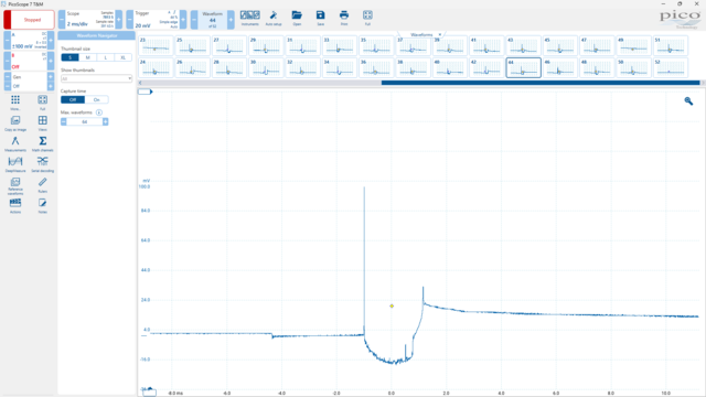

I'm completely new to scopes. bought dans book and watched videos but im still not sure what is going on with the burn line. car is a 2009 corvette. customer complained of a dead miss and violent shaking. car has ran fine since its been in the shop and i cannot recreate the problem. figured it would be a good time to try out my new scope.

That waveform has no firing KV, that I can see. I would suspect a shorted secondary, possibly. Can you post a waveform of the coil current ramp?

Thanks. The car has already been picked up. Never could get it to misfire 3 days in the shop, but that was the waveform I got while it was here. I did do a current ramp, but forgot to save it.
