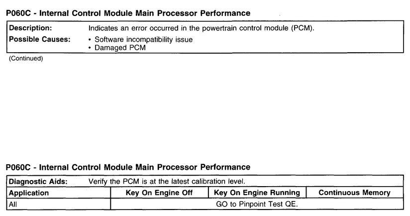

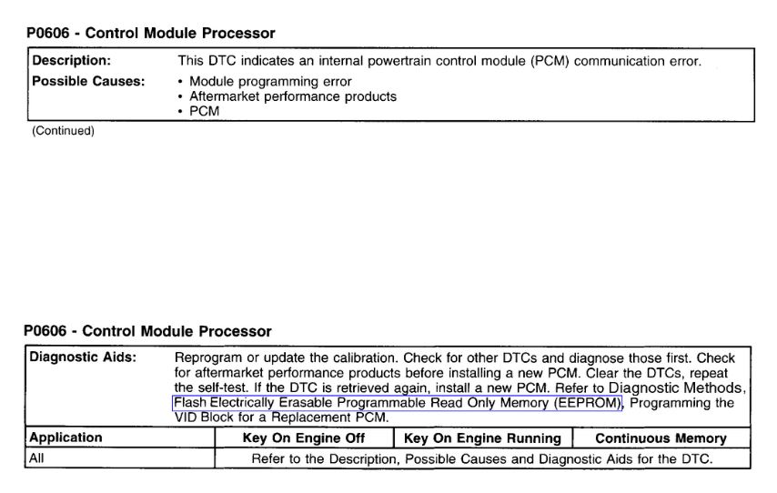

Using Forscan on my Laptop and connected with OBDLinkEX Model EX101 2.2. Forscan said OBD need an update which Forscan could carry out, so update installed.
I have the following DTC: PCM P0606:00-27, P060C:48-23

P06XX codes are, usually, internal module errors.
P0606
P060C
Make sure that you have good powers and grounds at the PCM.
P0606
P060C
