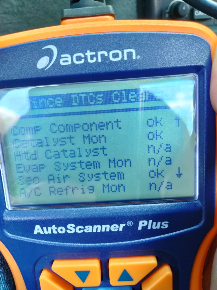

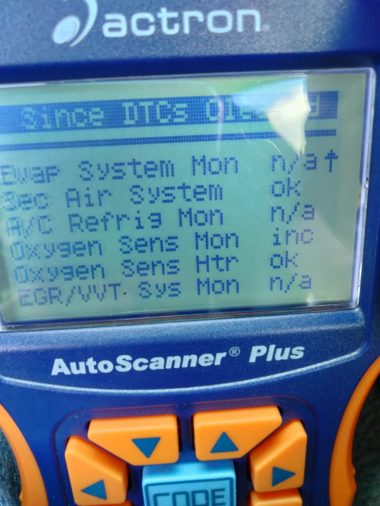

I took my 96 for emissions test today and surprised that it didn't pass. The drive cycle monitor for catalytic converter and heated 02 sensor didn't complete. This is my first time this year driving the Vette and I drove about 25 mins to the emission test facility and I thought the drive cycles would have been completed? Do I need to drive it longer? There are no codes and I haven't had this issue before the last time I look the emission test 2 years ago. Any suggestions?

Of course, if the battery were disconnected or discharged in storage, naturally the monitors would need to be run again, so to answer your question, yes. Drive it more.
