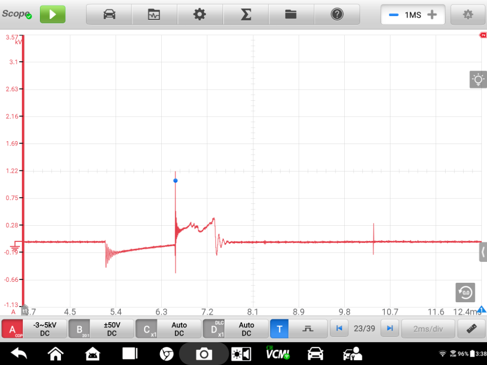

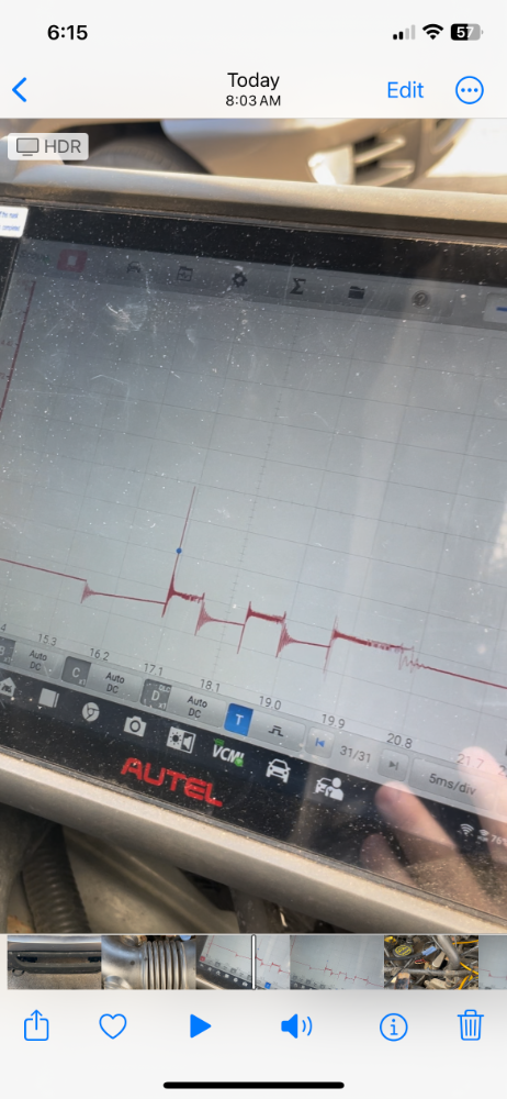

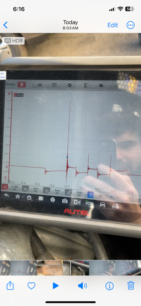

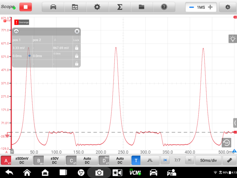

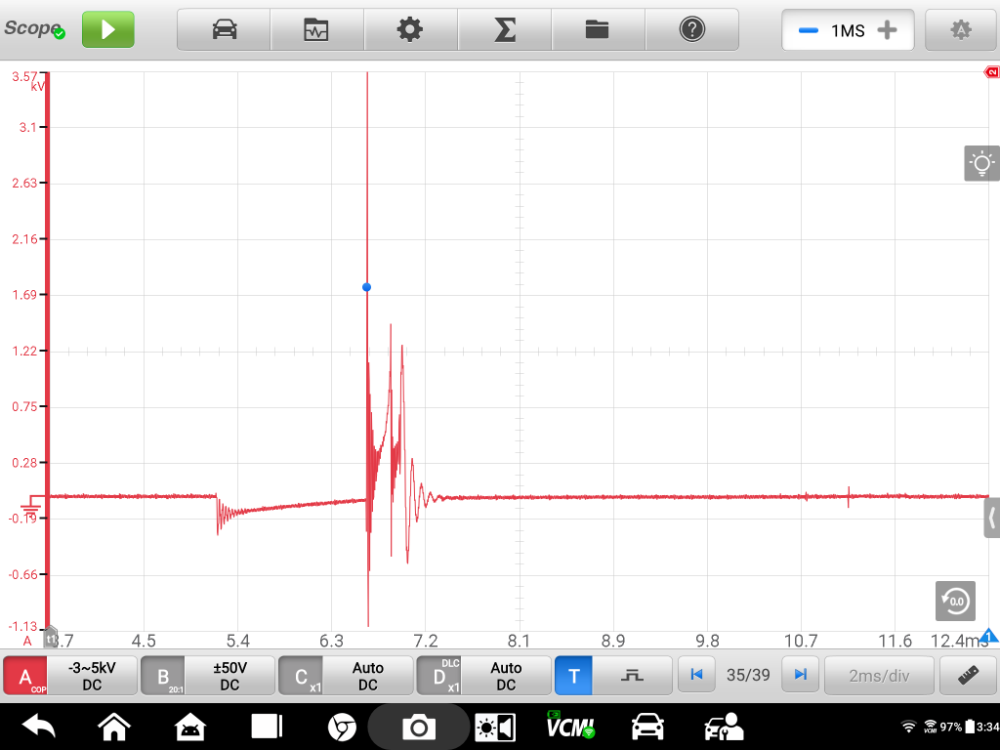

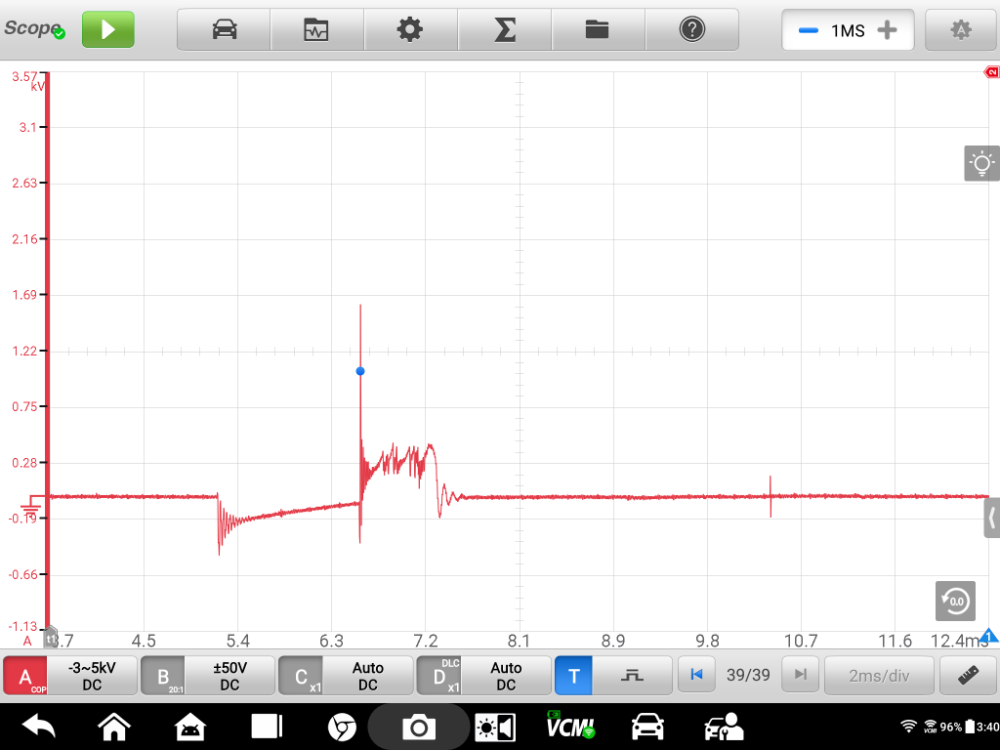

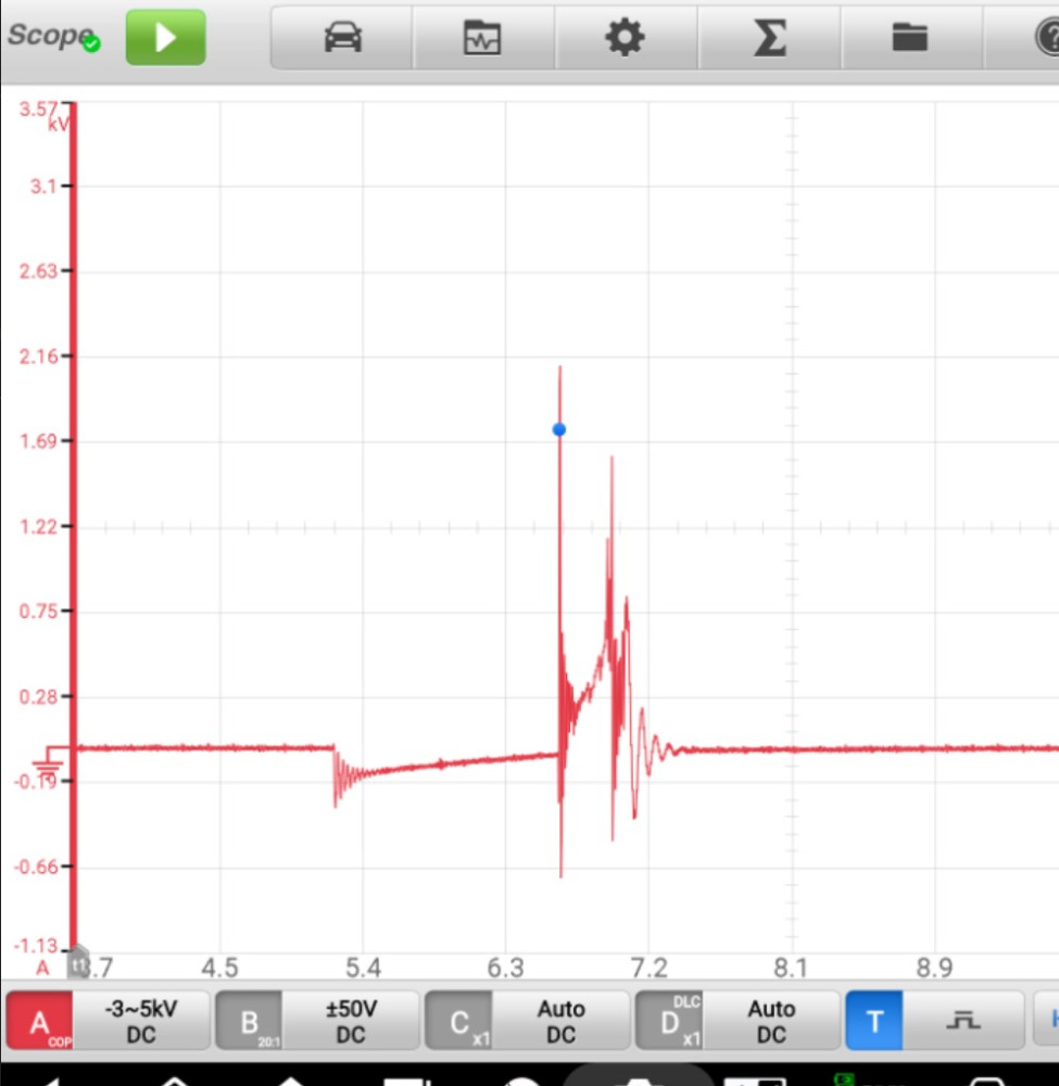

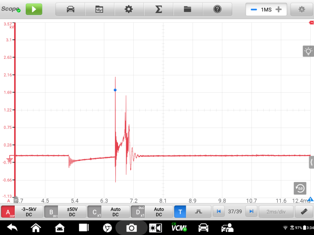

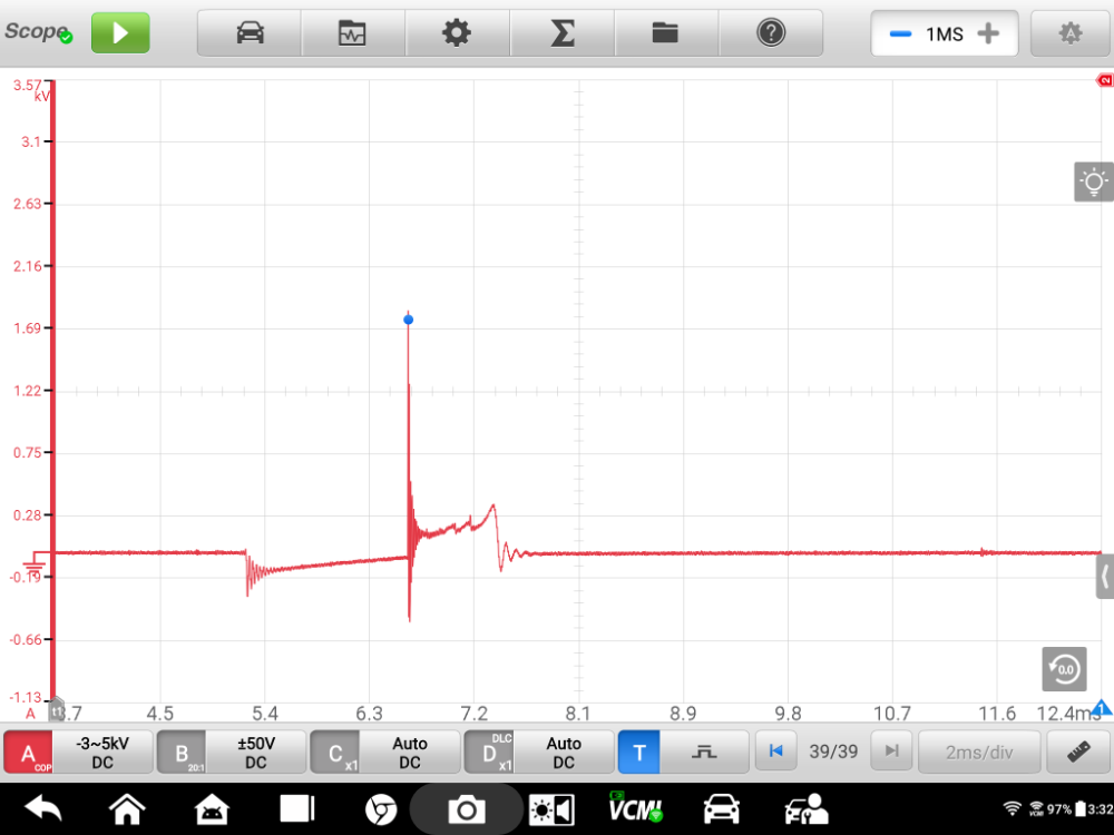

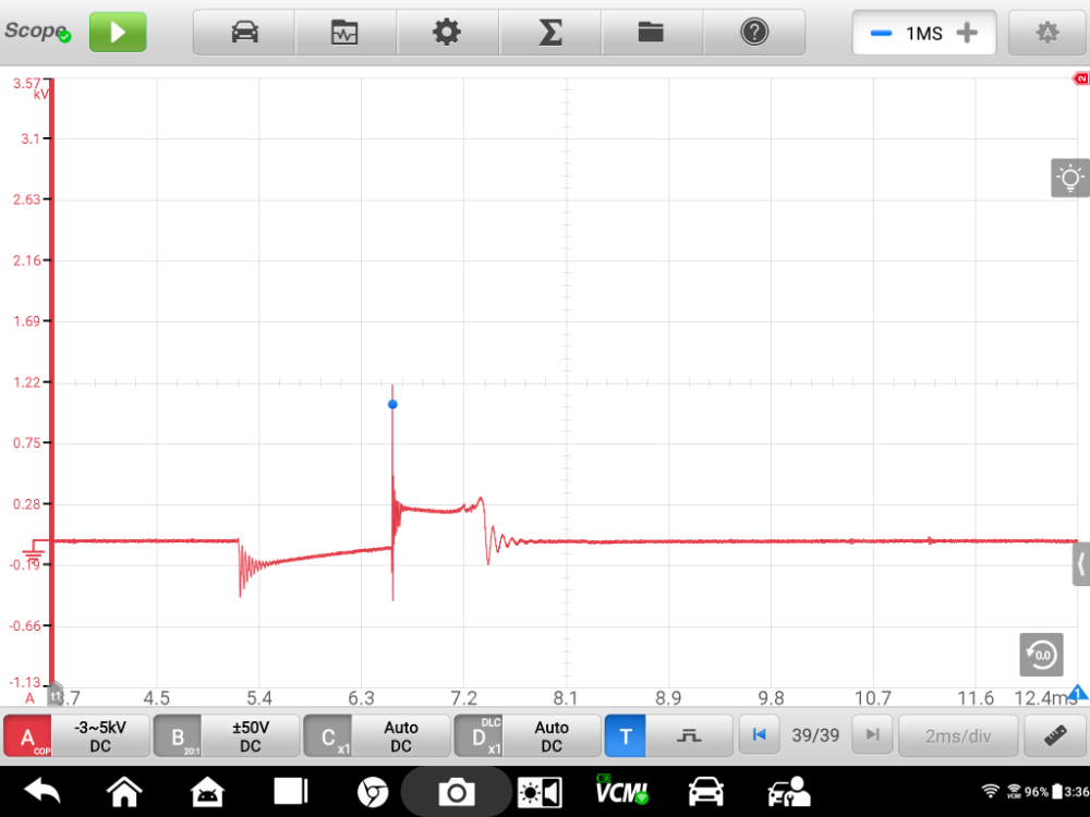

I grab a secondary ignition waveform. but first I grab a known good.  the first picture is a capture of a known good.  the second capture is #7.  sorry for the bad pictures.  the only anomaly that I see is the firing line is way higher.  the others spike to a max of like 3kv, and #7 spikes to sometimes over 6kv.   at idle.   I swap spark plugs and coils anyway, no change in miss and high spike stayed in #7

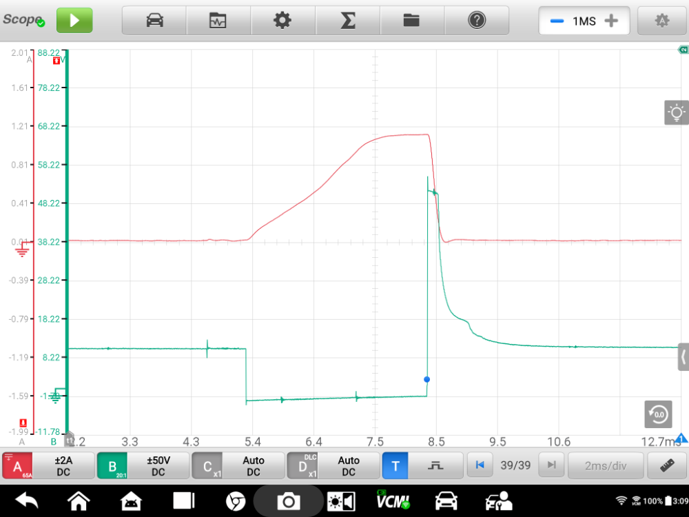

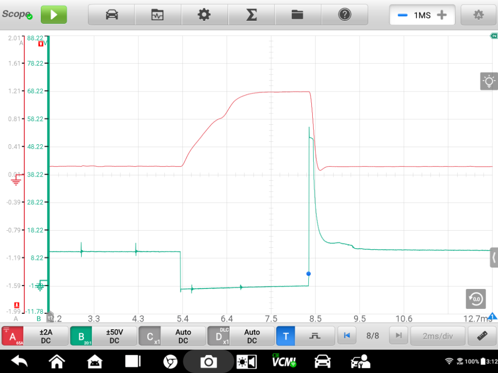

I then grab an injector amperage waveform, and it looks good (sorry no picture), goes to about 1.4ampsish.  I then grab another off the one next to it, and it has a VERY distinct pintle hump compared to the #7 I just looked at, so I am thinking injector.  I grab another known good, and NO distinct hump on that one either.   Well, great.  I do injector flow test through the zeus scan tool with my gauge hooked up, and all perform and drop exactly the same.  maybe 1 lb difference from one another, but nothing at all noticeable on the #7

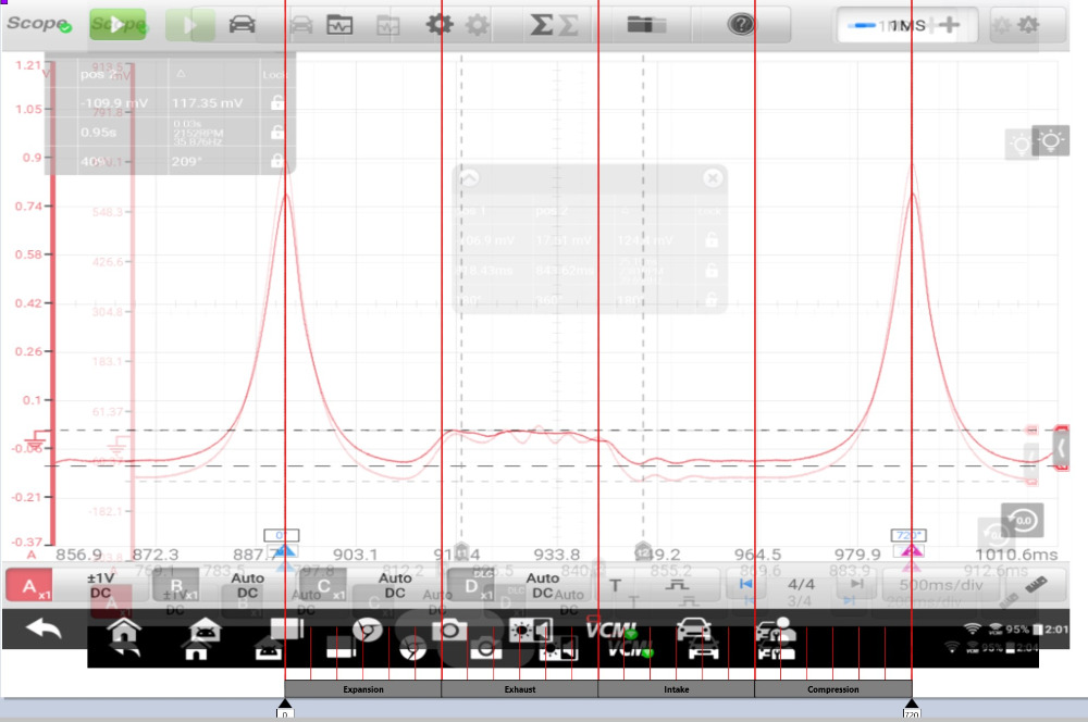

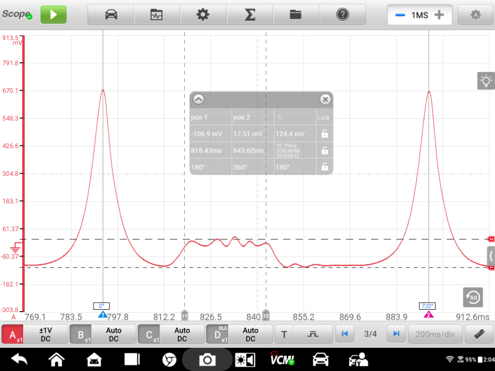

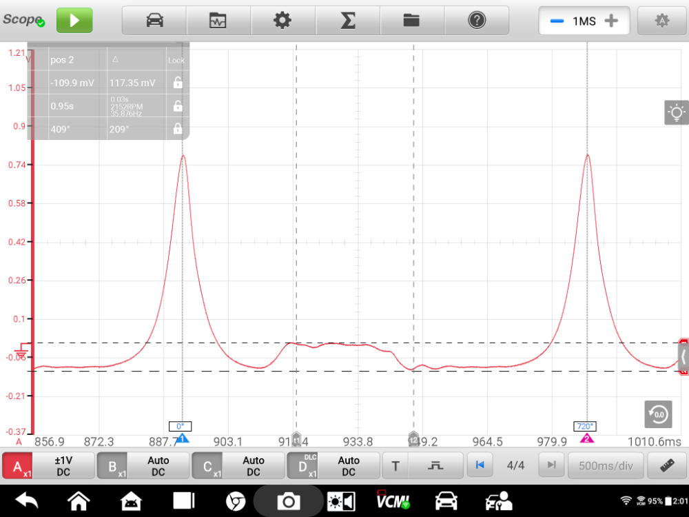

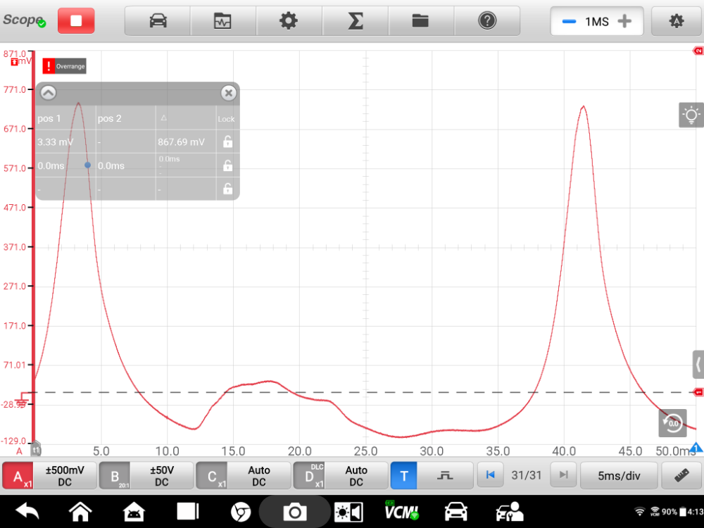

I do an in cylinder test.  1st capture is #7 at idle.  second capture is another known good at idle.  (I am new to in cylinder captures.  I forgot to capture a WOT capture.  but it missing bad and very rich even at idle, so Im thinking my problem has to present at idle as well somewhere.)  but as far as I can tell, everything looks good.   I gave a crack at measuring for timing, but not sure on the autel how to get a 3rd marker out there to measure at 540deg.  But no pressure in the exhaust as I can see.
Does look like exhaust is opening a little earlier.  does that look like a problem to you guys?  I do have a pico (that I am learning actually, it is also new to me, but I know I could take much better measurements on it) but someone is borrowing it right now lol.  anybody know how to get better measurements on the autel for the timing of this?
Raise the RPM's, slightly, just enough to switch from multi-strike, to a single ignition strike, and take a screen shot. Then, do a snap-throttle. Post those images, please.
The pintle opening can be seen in the amperage/current waveform. The pintle closing can be seen in the injector voltage waveform. I would like to see both waveforms for cylinder #7.

That was my first thought when I read  " fuel trims on B1 are normal, B2 are like -40 combined".  If the Cat on one bank becomes restricted, that bank will be RICH, and fuel trims on that bank will go negative. However, I do not see excessive exhaust pressure in the in-cylinder waveforms. There is a definite difference in the shape of the exhaust stroke, though.  It might, still, be a good Idea to dig a little deeper into exhaust back pressure on Bank 2.
I stacked both images on top of each other, and added a set of 720° markers. Timebase-wise, both wave forms have the same valve timing, and I don't see anything of concern, timing-wise. However, the vertical voltage scale seems to be slightly different, so it is hard to compare pressures but, the zero voltage lines are aligned. Is the "known good" waveform from Bank 1?

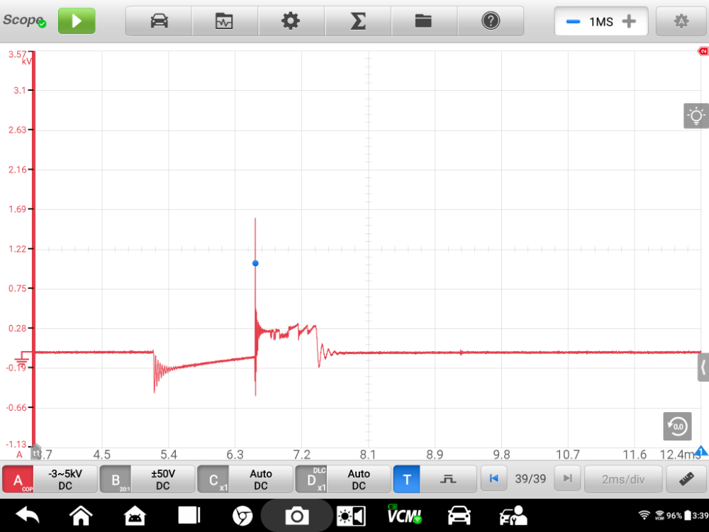

Well that is good information. I am starting to think that must be what is going on with this. Because, as you can see, my secondary ignition waveforms look very rich under WOT compared to others.
Also, I am not suspecting exhaust restriction now based on my in-cylinder at WOT

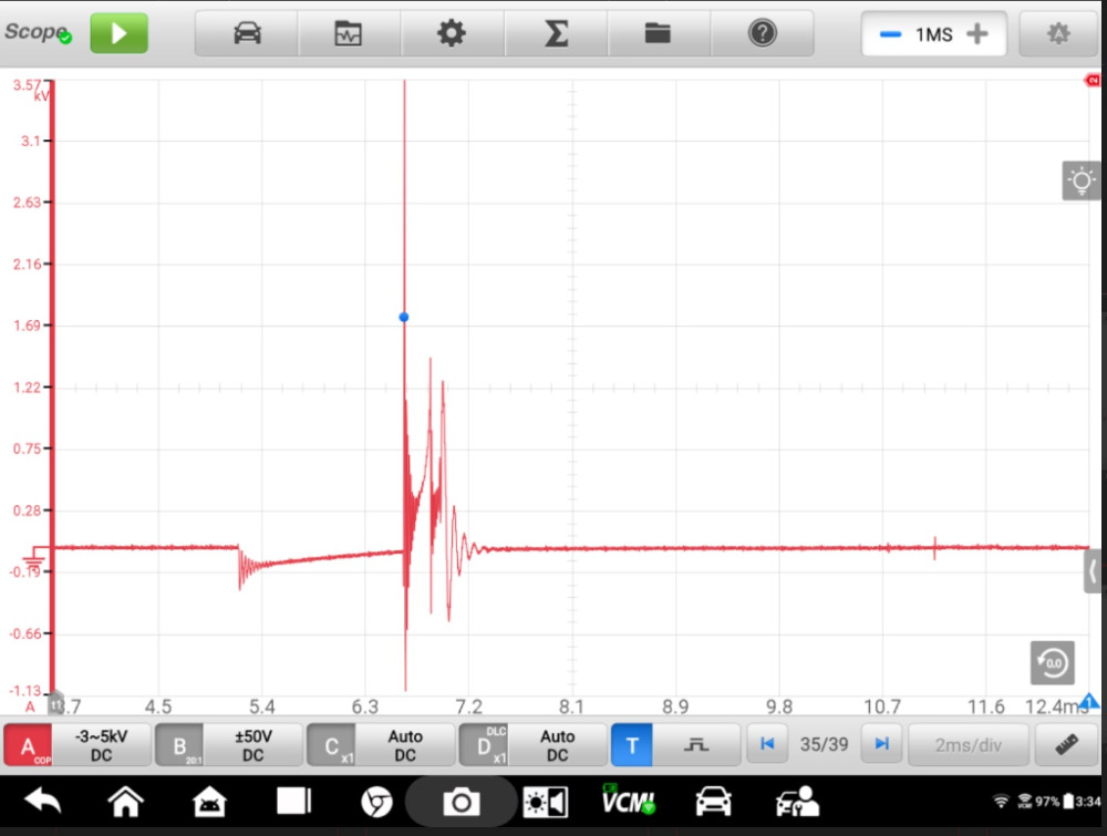

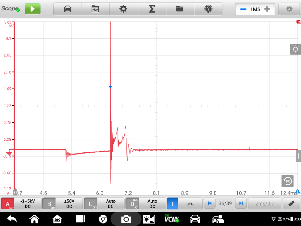

I took a bunch more captures and labeled them all here by changing the name of the files.  if you hover over the 'i' it should read out what it is.  I think.  lol

Here are a couple more captures
2 years 5 months ago #65698 by Chad
Nice captures.
A couple of them look like there may, possibly, be some valve leakage. I would like to zoom in on the spark line, on these two.

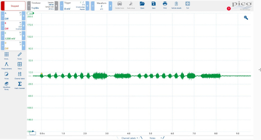

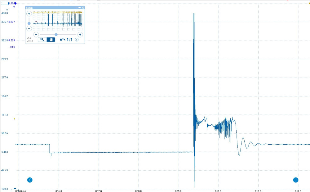

This a capture of a cylinder with valve leakage that I had a couple weeks ago. It was a very subtle difference in the RC waveform, and no irregular cranking cadence could be heard.
To prove valve leakage, a "leak-down" test should be performed. Roll the cylinder up to TDC of the compression stroke and pressurize the cylinder. Listen for air flow at the tail-pipe and in the intake manifold, for valve leakage. (You can listen to the Oil dipstick tube to check for leakage past the piston rings.)
I use a pulse sensor to detect the air leakage. This is a capture from the intake manifold, as I blasted air into the cylinder. Each event is a blast of air.
When cylinders leak, the air flow can disrupt the ignition spark, causing a turbulence that can be seen in the ignition waveform. This is not the video that I am looking for but, it is worth watching. There is a better video that I will post, if I can find it.
