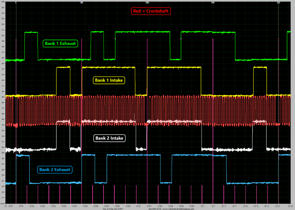

Do you have access to a labscope?

- Posts: 2222
2 years 5 months ago #65708
Replied by Chad on topic 2012 acadia run issues
If you happen to get a scope, here is a known good Cams/crank waveform. The intake signals should line up with each other, perfectly, so that if you stacked them on top of each other, It would appear as one waveform. The exhaust signals, however, do NOT line up. There is an offset of about 20° in the exhaust signals.
