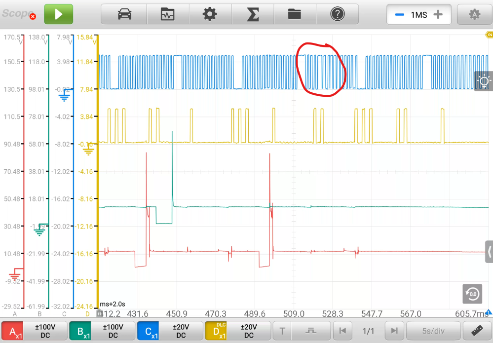

I'd say you're now down to getting your hands dirty and doing some testing. Or getting someone locally that has the time and know-how to do the same.
The nature of the stall/restart makes me think input problem (or interference). Less likely to be fuel delivery since it restarts immediately. I've seen other CDJR products with the P2173 fault - that fault usually isn't associated with a stall. Might be a symptom of the problem, might be unrelated.
This is HUGE if you decide to diagnose this one yourself. Being able to consistently reproduce the problem will allow you to work down a list of suspects.
I think the most important question to answer first is, what did the engine lose to make it stall? Spark, fuel, air? This is one of those times were a lab scope is invaluable, IMO. I recently had a Town & Country 3.8L that would intermittently stall. Watching the CKP (blue), CMP (yellow), spark (red) and injector pulse (green) during the stall revealed the problem:
All it took was a couple of skewed CKP pulses, and the PCM took spark and fuel injector pulse away. This is the kind of thing you'll want to be looking for during the stall.
