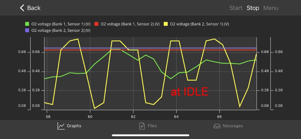

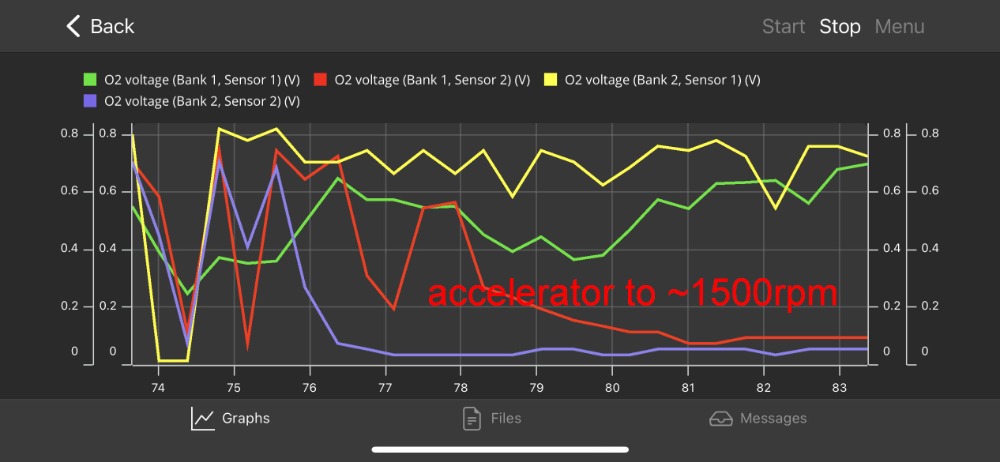

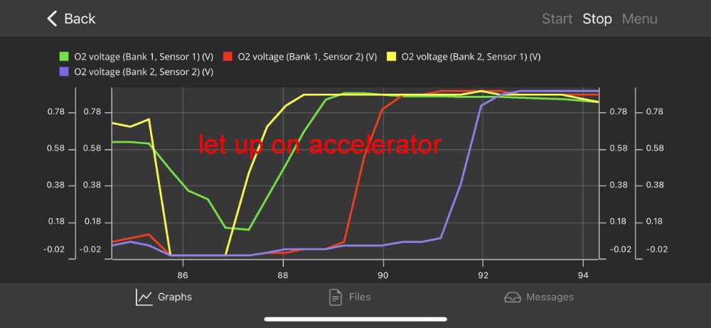

first graph is at Idle, second is while running ~1500rpm, third is releasing the accelerator and going back to idle.
