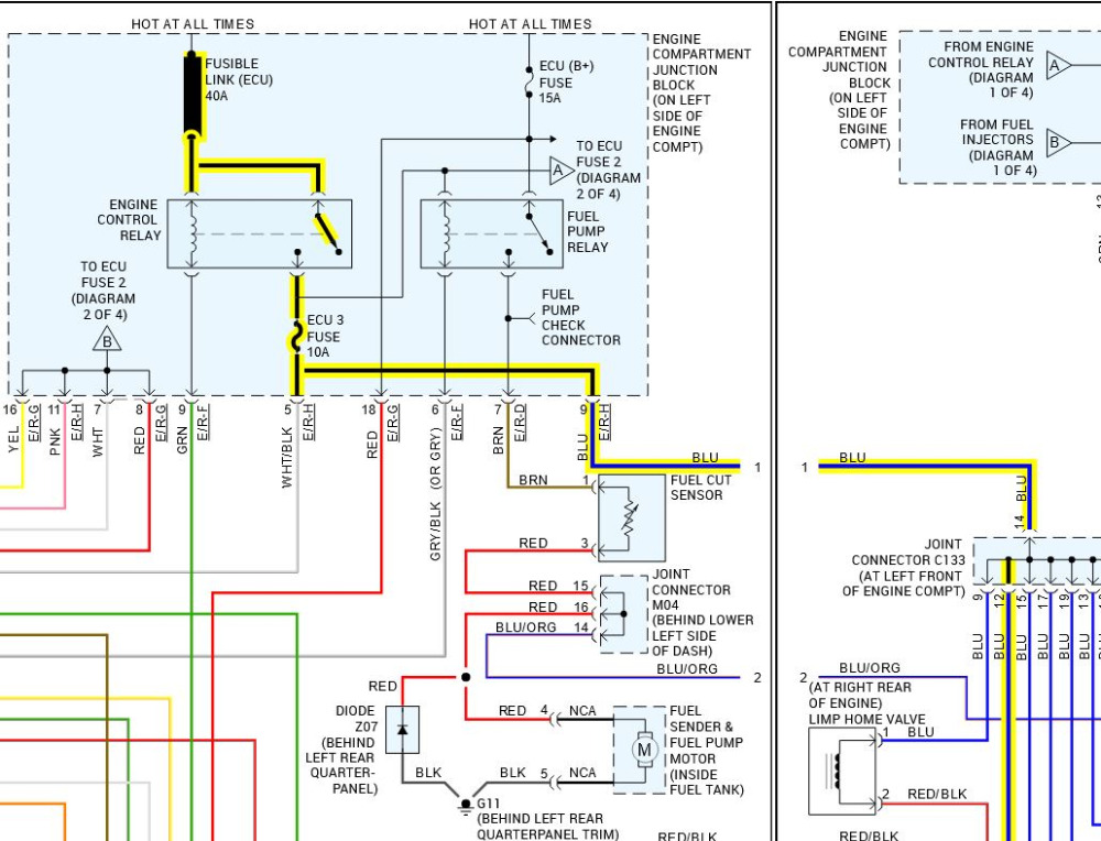

I'm convinced the EGR flow is OK since I can easily get the car to stumble or die when I manually open the EGR with a vacuum pump or command the solenoid closed, which opens the EGR. I
I found a wiring diagram for the 2.4L and it shows what I'm pretty sure is constant power to the solenoid and a ground side switch at the PCM.
At this point I think I just need to measure for 12V at the solenoid instead of across the solenoid then I can go from there, but I'm still interested in my original question, which is should the EGR ever be commanded open while revving the engine in park?

I just looked at the schematic and you should have power on the blue wire at the solenoid connector when the Engine Control Relay is energized. In the engine compartment fuse box, be sure that ECU Fuse 3 (10 amp) has power with the with the Key on/Engine running.
Put the negative lead of your volt meter on the negative battery post. Then check the voltage on each of the connector wires, individually. The power wire (blue) should show battery voltage. The ground wire (blu/org) will show battery voltage, (with the solenoid connected) when the solenoid is "OFF"/ NOT energized and should be very close to zero, when the PCM commands the solenoid "ON".
Replied by Chad on topic EGR issues on 2004 Hyundai Santa Fe 3.5
I DON'T get 12V at the solenoid connector under any conditions.
I'm measuring between the two connector pins.

Thanks, yeah that's exactly what I planned to do next time I have access to the car.
