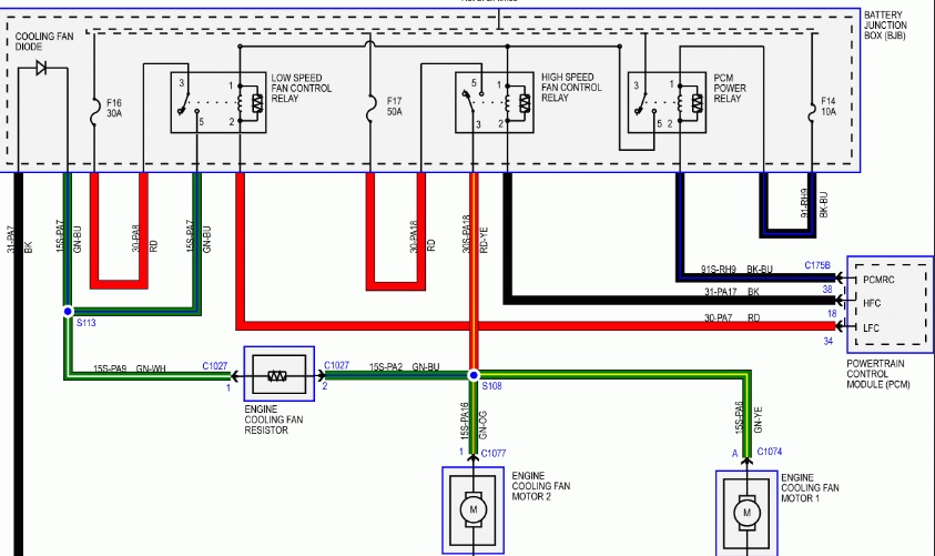

2.0 overheating found the fans were not coming on. checked relays not getting ground from pcm. used autel and turn the fans on still not coming on. checked at pcm to eliminate a broken wire im getting 12 volts at pin 18 and 34 but the pcm isnt pulling it to ground. backprobe those pins use test light to pull down to ground fans work! does this sound like the pcm is the issue here. Going to check powers/grounds tomorrow. and going to check amperage draw on the speeds. Does anyone know an amperage on these fan motors??

Went digging for a diagram, could only find a 2011. It sounds correct based on the PCM pin numbers?
Dunno about the cooling fan current draw... 30-ish amps at high speed would be my guess. But still, since the PCM controls the relays, I'm not sure that a fan draw problem would cause this. :huh: I don't suppose the fans come on with the A/C?
Not sure what the temperature the PCM has to see for the fans, but you've likely looked at that already. A pin tension issue on both pins is unlikely, as would both clamping resistors in the relays failing.

also forgot to mention fuse 16 and 17 were both blown.... so im going to do an amp clamp on it tomorrow while grounding the high speed fan pin at the pcm with a test light. the blades didnt feel tight or anything they spin with no resistance..
Ahhhhh now I understand why you wanted to measure the fans. ;-) I don't suppose there's any codes stored that might prevent fan operation?

found a bulletin aout on it. saying reflash the pcm etc. should be on bbb industries.com
9 years 3 months ago #11354 by Tyler
Interesting... The TSB indicates that the resistor can cause the high speed fuse to pop, but I dunno that I agree. :lol: Anyway, your resistor isn't open, so I guess it's just down to reprogramming?

well i think we can call this one fixed. i was using the autel ds708 went into there functional tests in ford tried to turn on both fan speeds nothing. replaced the resistor. did the test they have you do in the bulletin. reflashed the pcm to the latest calibration. everything started working right. hooked autel back up tried functional test again still nothing. must be an issue with the reverse engineered software. hooked up old school verus (dont use it much its just to slow) ran the key on engine off test fans cycled
