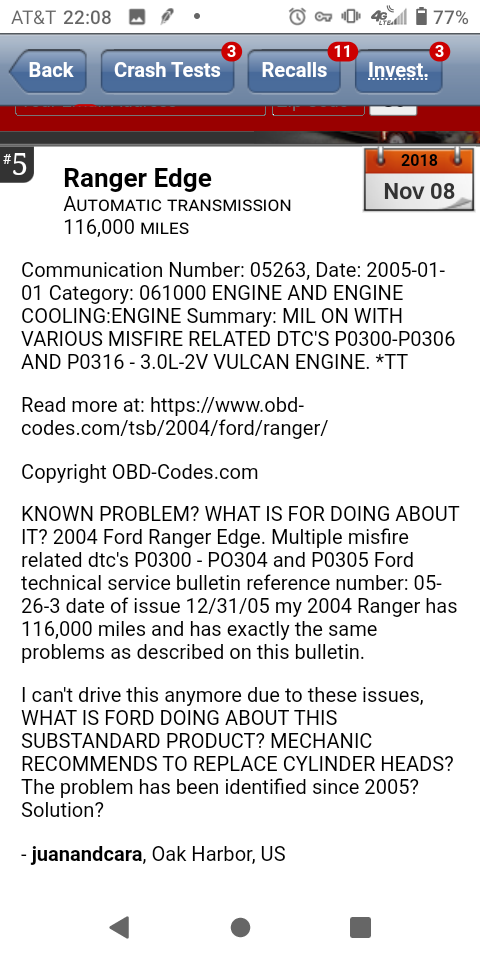

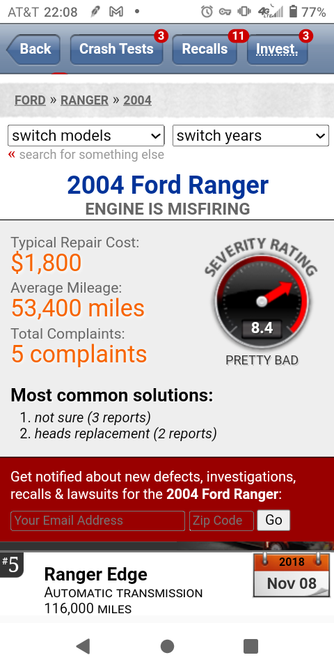

Codes are P0300 P0304 P0305 P0306 P0316 P0174 off the top of my head. I can feel, hear and smell the misfires. CEL goes from steady to flashing. It is idling around 815 with minimal misfire until I put it in any gear. Even worse, almost dies, if I turn on the blower motor. Stalls on take off at times, but now won't hardly go, so I've kept it parked all week. I found a bulletin online today about faulty heads on 2004 through 2006 of this model with a Ford communication #05263. If this is the case, then it's probably gonna cost more than it's worth to fix. Especially if I cannot do it myself. This is my only vehicle and I'm 20 miles from the nearest small town. 60 from any decent mechanic. I have an OBD2 that showed up in the mail today. I have never used one and I am only experienced in basics from needed repairs on several old junkers over the years. Thank you for getting back with me and for any advice.

I would take the information you found online about the cylinder heads with a grain of salt for now.
I'd probably start with checking fuel pressure based on the symptoms and codes you described
