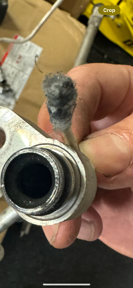

Well, I've come this far, just unloaded the parts cannon, ordered new condenser and new suction/discharge lines and pressure sensor via Amazon grand total $199 out the door. I pulled condenser, it's original looks like some silver slurry in the ports! guessing previous owner had Black death, grenaded compressor? I will have a whole new ac system at this point, peace of mind, I will update when I get the parts installed.

Woes no more, I installed new aftermarket A/C Condenser and I was able to source A/C manifold set from salvage yard $75 because the set from Amazon wasn't complete (lacked some of the aluminum piping from condenser to evap and another short piece on low pressure return line from port to evap), I flushed the lines, they were much cleaner than original, no black soot, installed new o-rings, lubed them, evacuated for about thirty minutes and recharged, freezing me out now. The other day, I called my local Honda dealer for new evap core, they wanted $750 and expansion valve $201, I said no no no, I need only the evap core not the whole HVAC case, he's like I know it's $750, hahaha, I ordered EVAP core from local salvage yard and when I picked it up, they gave me the whole case $100. I loved the challenge, I'll sleep better knowing everything is up to par.
