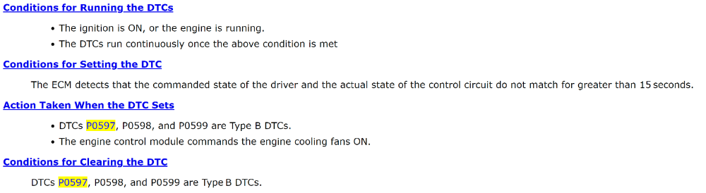

2 years 3 months ago #66260
Replied by Tyler on topic A/C Works Only After ECM Reset
Congrats on the fix! We always appreciate the follow up.
GM dropped the ball on that one, IMO.
Now isn't that interesting. Because I looked up GM service info for P0597 - it didn't say anything about taking the compressor away.I had found that the A/C would stop working after 4 engine start cycles, and it's been working for a lot more than that, over a week now.
