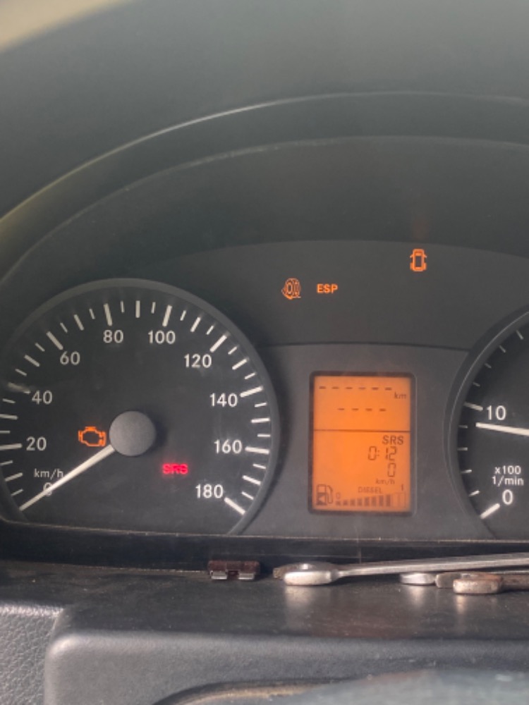

Good day everyone
I need help on a Mercedes sprinter 2007 CDI OM 646 engine
ABS and brake lights go off when engine is started, but ESP ASR/BAS lights stay on
the following DTC’s are current and stored under ESP7201 The CAN message from control module Engine is invalid or implausible
51A5 CAN signal acceleratior pedal value invalid
7266 cruise control - control unit N30/4 (ESP control unit) not available The following DTC is stored under engine DRIVE
I have 5v on Apps sensor 1 and 2
i have sensor 1 ground 0.14v
I have sensor 2 ground 0.01v
i have good signal voltage on apps sensor 2, and also the xentry software reads 0%at idle and 100% at WOT
I DO NOT have any voltage or percentage readings on apps sensor 1 signal
How do I address these faults
where should I start from
Is the apps fault causing the esp bas/asr faults
is the esp BAS/asr causing the apps fault
kindly give your expert advice sirs

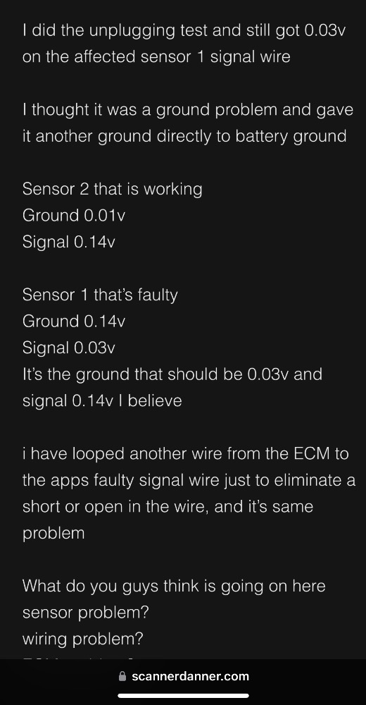

APPS  SENSOR right to left wire reading
1. Yellow/red. 5v  supply sensor 1
2. Yellow.   Signal 1 signal voltage is too low (short to ground or open signal wire) 0.03v
3. Yellow/brown. Sensor 1 ground 0.14v 12.52v to battery positive
4. Brown/white.  Ground 2 0.01v sens 2 12.66v to battery positive
5. Pink/violet 5v supply sensor 2 shares with boost pressure sensor on the intake beside MAF via connector Z7/86
6. White signal 2 works fine 0.14v at idle
I did the unplugging test and still got 0.03v on the affected sensor 1 signal wire
I thought it was a ground problem and gave it another ground directly to battery ground
Sensor 2 that is working
Ground 0.01v
Signal 0.14v
Sensor 1 that’s faulty
Ground 0.14v
Signal 0.03v
It’s the ground that should be 0.03v and signal 0.14v I believe
i have looped another wire from the ECM to the apps faulty signal wire just to eliminate a short or open in the wire, and it’s same problem
What do you guys think is going on here
sensor problem?
wiring problem?
ECM problem?

1 year 9 months ago - 1 year 9 months ago #68080 by babajis2010
Replied by babajis2010 on topic ESP ASR/BAS & APPS FAULTS
Update on the fix for my apps dtc
After series of tests, I realized that the ground for the faulty apps sensor 1 was not the best. I connected a different ground wire from the battery negative terminal to the apps sensor 1 ground and that didn’t fix it, I also used the ground wires coming from the air flow meter and
MAP, but that didn’t fix it either.
I have now combined the ground wire of apps sensor 2 to sensor 1 ground and my apps DTC went away. Although I’m having a feeling the problem might also be coming from the connector of apps. But for now I’m so happy I’m putting the apps fault behind
My vehicle is still in limp mode though, with exhaust gas recirculation DTC.
I’m going to find my way around or open a new thread for that if it’s too difficult for ne
Special thanks to everyone that responded here
The fix of this apps DTC this time around is fixing the ground
a rule of thumb I followed was knowing that a good ground should read 0.01v, anything higher than that is very suspicious
