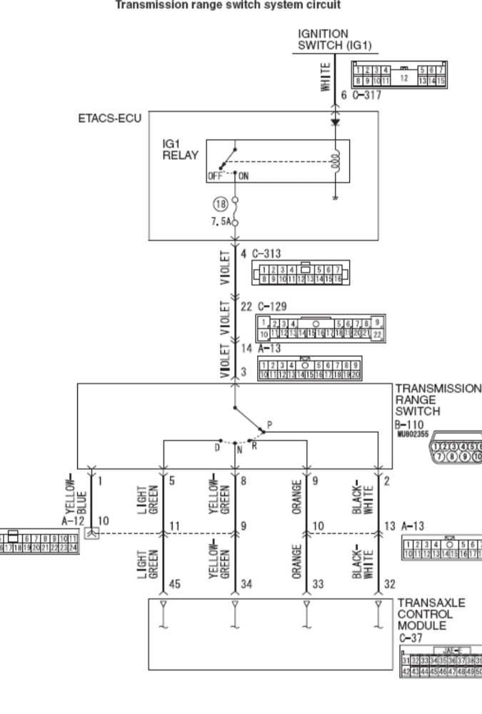

You should have power on the violet wire with the ignition on.
And power on the black and white wire in park.
Power on orange in reverse
Power on yellow and green in neutral
Power on green in drive
The violet will always have power regardless of position, but if any two of the others have power at the same time, this code will set.

Then the orange wire is shorted to power or the switch is sending power through when it should not.
How about with the 7.5amp fuse referenced in the diagram removed?
  • sachin.raj.shakya
  • sachin.raj.shakya's Avatar Topic Author
2 years 4 months ago #66007 by sachin.raj.shakya
Replied by sachin.raj.shakya on topic P0705 Mitsubishi outlander 2008
If the fuse is removed the lightgoes off .so does the display on the combination meter for reverse gear . (Meter only shows R)
2 years 4 months ago #66008 by Noah
Replied by Noah on topic P0705 Mitsubishi outlander 2008
With the tcm and the gear selector switch disconnected, I would ohm each output against each other to be sure there are no shorts (crossed circuits) in the harness.

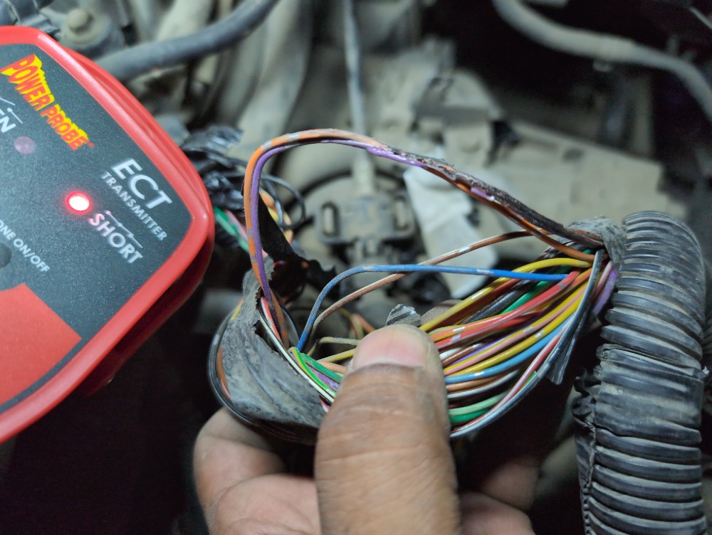

Not getting any ohm readings between the wires . But there is continuity between the violet and orange wire .
  • sachin.raj.shakya
2 years 4 months ago #66010 by sachin.raj.shakya
Thanks Noah , the orange ad violet wires were shorted. Thanks to the ect3000 power probe.
I'll update once I get new wires installed.
2 years 4 months ago #66018 by Noah
Yessir, there she is!
Nice job. I have found that tool largely useless, this is the first time I've seen anyone actually find the problem with it!
Looks like she got hot, was it touching exhaust?
  • sachin.raj.shakya
2 years 4 months ago #66019 by sachin.raj.shakya
Not touching the exhaust, wires were covered with flexible plastic cover. No damages there very clean.
Wires found shorted from selector switch to a connecter in the engine bay , still have to tear it open to see how far in it has shorted
