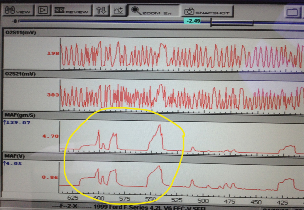

Replied by Ben on topic Re:F150 Lack of Power Under Load
What do your maf readings look like at idle and at wide open throttle while driving
- Ben
- Posts: 1098
- Thank you received: 215
9 years 3 months ago #11321
by Ben
Also what does your front 02s say under same conditions as maf test
- Ben
- Posts: 1098
9 years 3 months ago #11322
by Ben
If possible I'd like to see these tested when it's acting up but may be able to get something useful out of it even while it's running ok
- jcsloan
- Posts: 18
9 years 3 months ago #11383
by jcsloan
The reason I"m here . . . 1999 Ford F150 4.2L 2wdr w/300,000+ miles
Replied by jcsloan on topic Re:F150 Lack of Power Under Load
Circled area is at WOT. This doesn't always happen. Checking mode $06 Test Id $53 I found cylinder 3 with 218 misfires and cylinder 4 with 436 misfires. Hopes this helps.
9 years 3 months ago #11395
Replied by Tyler on topic Re:F150 Lack of Power Under Load
Nice capture! Seeing the MAF get to 4V eliminates a lot of potential suspects.
Also, good idea checking Mode $06.
On a hunch, I Googled the firing order for this engine:
Cylinder #3 and #4 are companions, and share the same primary circuit in the ignition coil. Its just a guess, but there could be a primary issue going on that's causing weak/no spark to those two cylinders.

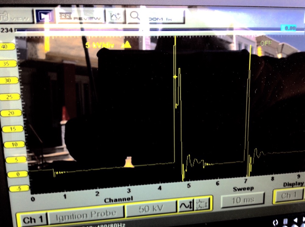

- jcsloan
- Posts: 18
9 years 3 months ago - 9 years 3 months ago #11402
by jcsloan
Last edit: 9 years 3 months ago by jcsloan. Reason: Attached pic

9 years 3 months ago #11422
by Ben
Can you scope the primary current for that coil?

- jcsloan
- Posts: 18
9 years 2 months ago #12321
by jcsloan
Replied by jcsloan on topic F150 Lack of Power Under Load [FIXED]
Second set of wires for the fix. Originally replaced wires and plugs before I switched out the coil. Seems that somehow the coil burned out a set of wires, cylinders 3 and 4. When tested with an ohm meter both tested open. Found this intermittent fault while moving the wires while scoping the secondary on 3 and 4.
