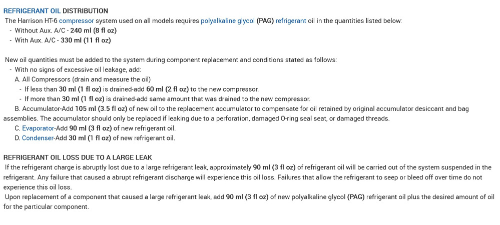

A few days later, the new one arrived and it did not come with any oil in it so I knew I had to add oil and rotate the compressor (and just not the belt pulley) to circulate the oil.
Here is where things start to get interesting. I could not exactly find the specifications online for how much to add back to the compressor online. I do not have a subscription to Mitchell or Alldata and our library does not have this information either. They may have a repair manual that I could've looked into but I did not think of that until now as I typed this post.
So I errored on the side of caution and put in 3oz of oil. Rotated the compressor a few times to get the oil moved around and installed the new unit.

2 years 3 months ago #66330 by Chad
That is a pretty safe bet. So far, so good.

Could there be little to no oil in the system?
Not knowing the history of this problem, it is very possible that the system is lacking oil. The best thing to do would be to disconnect all line connections and use a chemical AC solvent/flush the flush the entire system. Then, add the appropriate amount of oil to each component.
Could the system be still overfilled with oil? Again possible. I did not work on the vehicle when the compressor was changed originally and as we all know, there is no dipstick to check oil level here. Supposedly according to the internet, there is a sight glass on the back of the compressor in which you can see the oil in the compressor. Looking down at this sight glass, I cannot see any level so I'm not sure here. Also there is no traditional sight glass like on some of the other systems in which you can look into the system unless it is the one on the back of the compressor. Again not sure.
I suppose, it is possible that there is too much oil but, I would say that is unlikely. If you want to be sure, flush the entire system and add the proper amount of oil to each component.

Thank you for your insight and the pic talking about the oil. That is helpful. Now I get to have a headache for the rest of the day dealing with GM about this.
