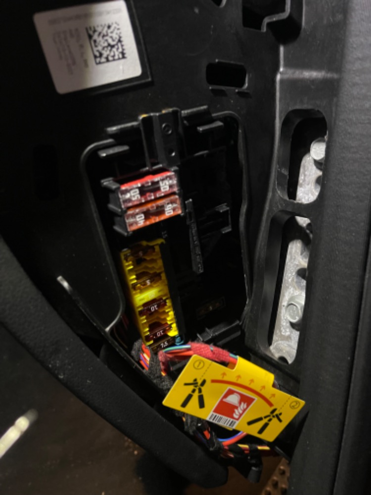

Hi guys
Eqc Mercedes 21 model
No ignition , v12 was dead jumped started but still nothing , can’t even lock or unlock vehicle with the key fob.
After jump start ( interior lights and wiper worked ) but nothing else.
Is it possible the high voltage disconnected ? I checked
1- the cable on the side looks fine
2- the plug in the engine is fine
Please any help or suggestion where to look ?
Do these cars need to shut down by using a scan tool ? Or reactivate by using scan tool ?
see attached video and pics
