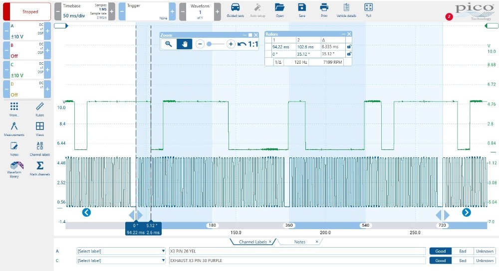

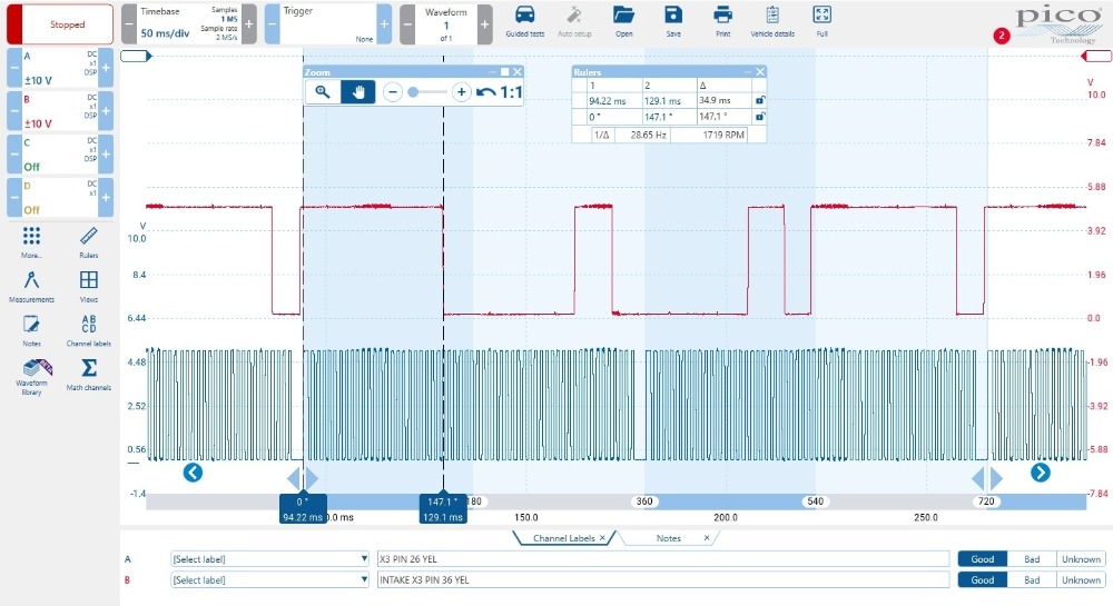

Here are some Bank 2 Known Good Correlations.
You must have a late model to have 4 Cam sensors, so under Service Info it's a 2010 model year.
This is the engine that is prone to the crank gear slipping on the Crankshaft because it is pressed on and not keyed.
Do you have codes for both banks?
Using a scan tool what are the timing variances?
This has a 30 tooth crank sprocket so 360 degrees divided by 30 gives us 12 degrees.
If memory serves me correctly the PCM will set correlation codes maybe 10 degrees plus.

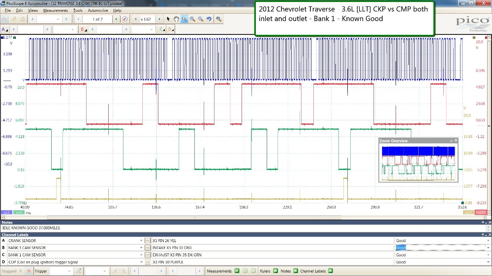

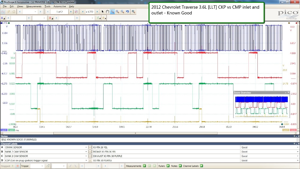

Here are better known goods for both Banks;
Bank 1
Bank2
Here is another;
Bank 1
Bank2
