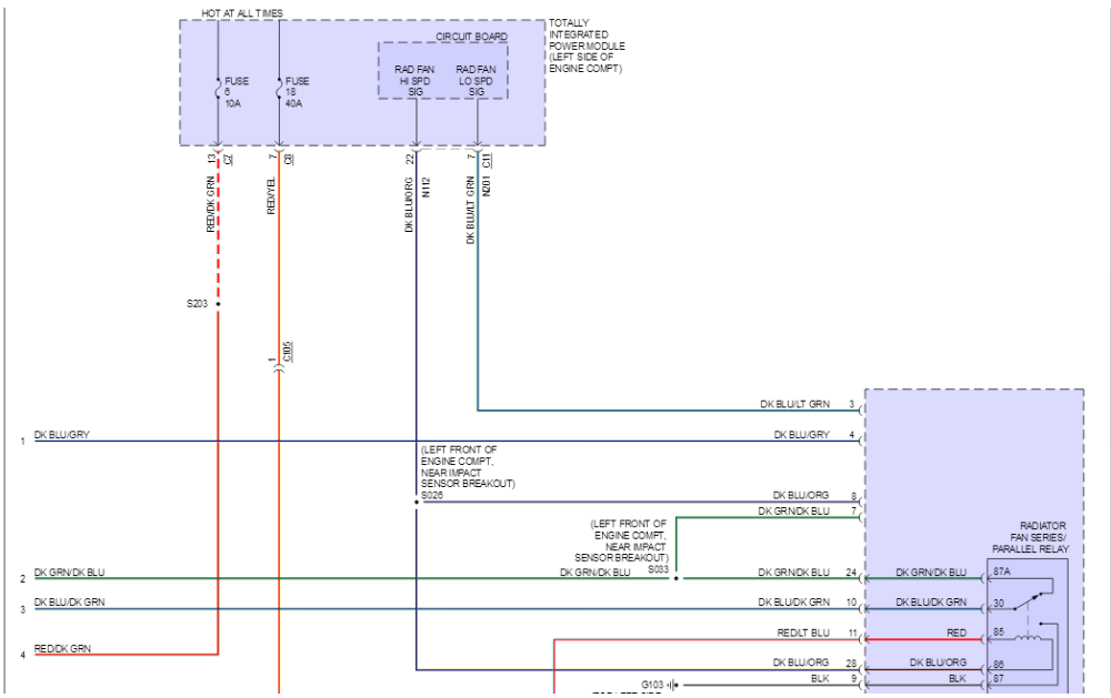

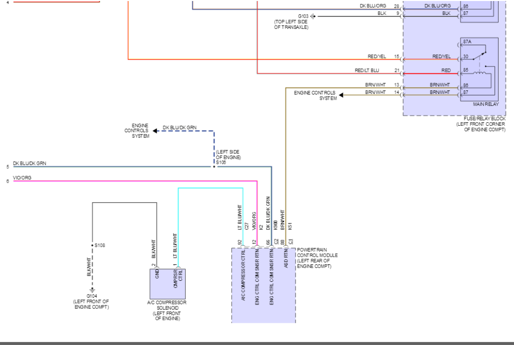

9 years 3 months ago #11344 by Chad
Replied by Chad on topic Re:Dodge TIPM
Here you go.

9 years 3 months ago #11367 by Tyler
Replied by Tyler on topic Re:Dodge TIPM
Are you sure that this Caliber has a compressor clutch? Because every Caliber/Compass/Patriot/whatever I've seen had no clutch, just a variable solenoid. Please let me know if I'm wrong. :lol:
If it's not cooling at the vents, then I'd start with a current measurement at that solenoid. Generally, I find those draw about 1A when the solenoid is commanded wide open.

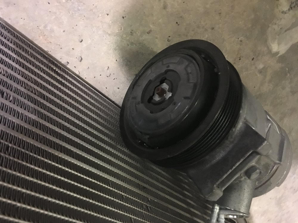

9 years 3 months ago #11385 by Dave101
Replied by Dave101 on topic Re:Dodge TIPM
Tyler wrote: Are you sure that this Caliber has a compressor clutch? Because every Caliber/Compass/Patriot/whatever I've seen had no clutch, just a variable solenoid. Please let me know if I'm wrong. :lol:
This is what locked up. It also has a two wire connection. I can't get any power to the new one in the car. I also tried a functional test with my scanner to no results. Any direction you can provide would be greatly appreciated.

9 years 3 months ago #11386 by Dave101
Update.. I hooked my scanner to this vehicle and could not perform any functional test. I hooked my scanner in doom mode and checked at compressor and was getting negative.12 vdc. Reversed leads and now getting 12vdc. Have no other choice than to assume I received a bad compressor. What I am stumped on is why was I getting -vdc? By the diagram, I had my leads connected correctly.

9 years 3 months ago #11387 by Dave101
Found my mistake about the negative voltage. The new compressor came with new plugs, one red and one black. When you plug in the connector, the red wire is the ground. I feel better that I got a bad compressor.
