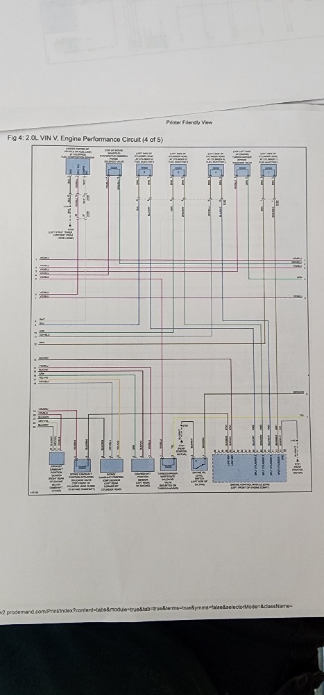

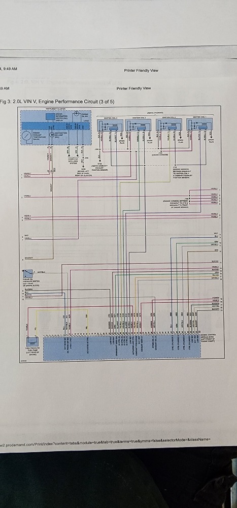

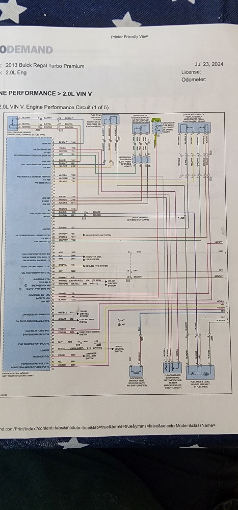

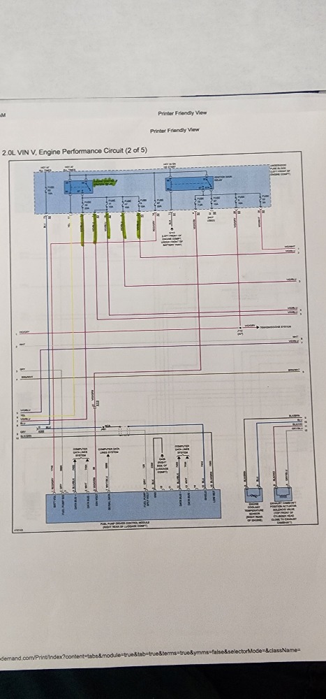

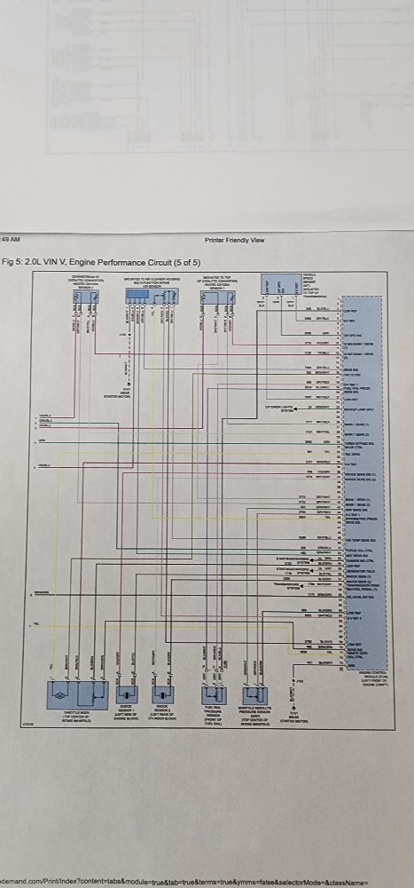

2013 buick regal 2.0 turbo with about 340,000 on the clock. It has sat for about a year ran good when parked. Wanted to use the car changed the battery and it won't start and is littered with codes. Cleared the codes and get P1682 and P0689 just with ingition turned on (has push button start with keyless entry) started checking fuses and half the box is dead. Tracked that down to 2 relays not working ignition main and engine controls ignition relays switched relays with another with the same result so I'm guessing the relays are good. Started checking power to the relays and the ignition main as batt V on pins 30 and 85 but the engine controls ignition which is hot in on or start has batt V in 3 (30) but only .64V on 2 (86). I have both the engine performance and power distribution wiring diagrams for reference but not sure where to go from here because nothing really says where that pin 86 gets power.
