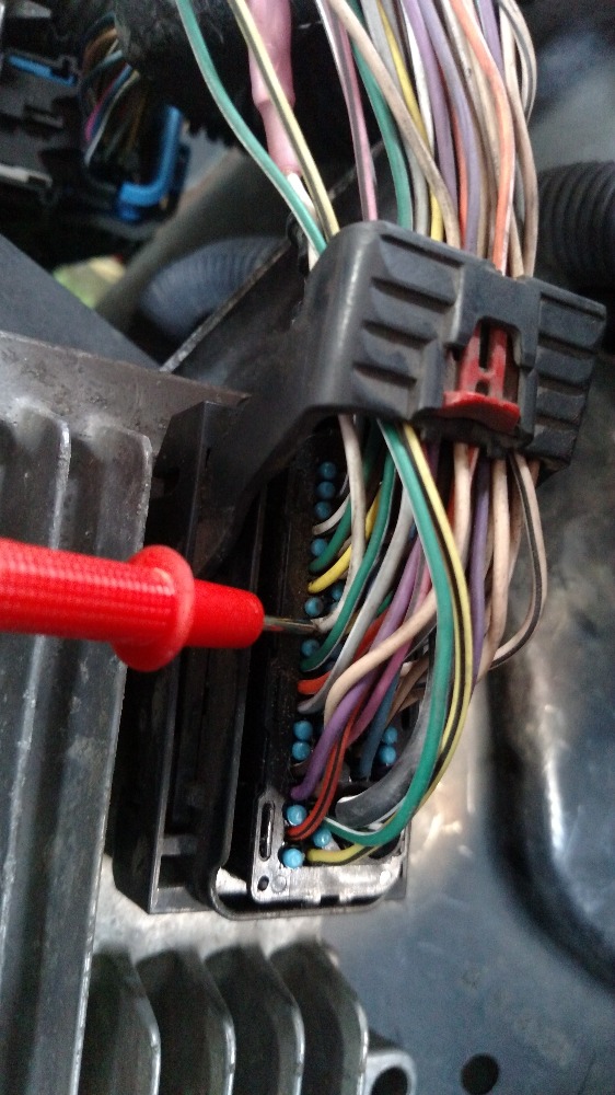

Have replaced the EVAP vent solenoid already. I believe I have a bad control wire (WNY Rust Belt). I have 12 (and some change) volts from the ECM, but have 0 volts at the EVAP vent solenoid (from connector to about 12 inches into wiring harness). I have no way of turning the driver on or off (no scanner) to verify. Is the wiring the same color all the way from ECM to solenoid (believe it is pink/white)? Don't want to short anything out by running new wire to the incorrect wire haha.

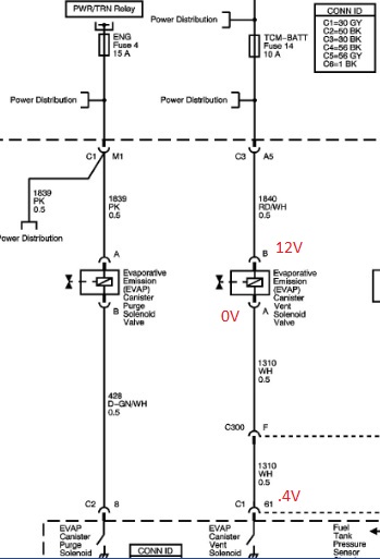

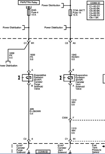

9 years 3 months ago #11378 by Tyler
Replied by Tyler on topic p0449 on a 2007 GMC YUKON 5.3flex
Here's the diagram:

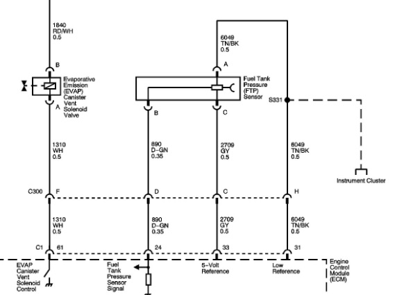

Now that we've got a power feed, I think your next move is to recheck for voltage at the PCM itself. OR, there's another option:
It looks like C300 is a bulk connector that has the fuel tank pressure, the pump, the vent valve and the level sender in it. I don't know where C300 is, exactly, but it's the next easiest place to check if you can locate it.
If you can't find C300, or it's a pain to get to, just go direct to the PCM. Pin 61 of C1, a white wire with no wires to either side (according to the diagram, anyway). KOEO, there should be 12V. If you find 12V, then that would suggest a PCM problem. If you find less than 12V, that would suggest more wiring issues.
Let us know what you find, and we can figure out the next step. :cheer:

So I have .40 volts at the ECM/pcm white wire. I have 12.1ish at the red/white wire at the evap vent solenoid and 0volts on the control / white wire. If I have .4 volts at the computer, would that tell me the computer is the culprit?

Woozybiffo420 wrote: So I have .40 volts at the ECM/pcm white wire. I have 12.1ish at the red/white wire at the evap vent solenoid and 0volts on the control / white wire. If I have .4 volts at the computer, would that tell me the computer is the culprit?
The 12V reading on the red/white wire is definitely good, but I thought you had 12V on the white wire at the solenoid? :huh: Not trying to nitpick, just making sure I understand where you're at. ;-)
So, with the key on and everything plugged in, is this accurate?
I ask because the above is describing either a functional circuit, or an open vent solenoid. :unsure: If we actually have 12V at the vent control wire, and .4V at the ECM, then that is showing excessive resistance. Paul: "Make sense?" :silly:

So I am a bone head and was testing while the solenoid was not plugged back in. I have 12v in 12v out and .4 at the ECM.
9 years 2 months ago #12148 by Tyler
Woozybiffo420 wrote: So I am a bone head and was testing while the solenoid was not plugged back in. I have 12v in 12v out and .4 at the ECM.
:lol: No worries! In that case, you're DEFINITELY looking at an open/high resistance in the control wire.
This is where finding where C300 comes in, as it'd enable you to split the circuit and reduce the amount of wiring you'd need to check. Otherwise, you're down to visual on the harness, or picking the control wire out of the harness and testing for voltage.
OR, if you just want the stupid thing fixed, run a new wire. ;-) :lol: It's not the ideal solution, but it is one I'd consider if my best efforts to find the issue got me nowhere.

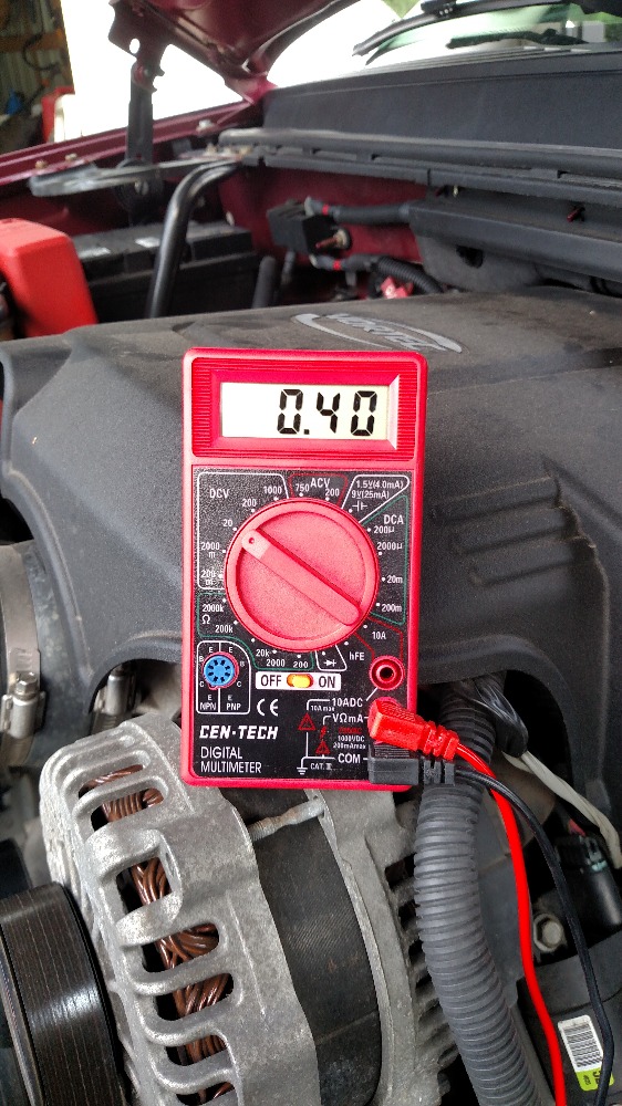

9 years 2 months ago #12171 by Woozybiffo420
Replied by Woozybiffo420 on topic p0449 on a 2007 GMC YUKON 5.3flex
Gonna grab a cheap VOLTMETER on my lunch and see what i come up with. When I ran that wire i was about foot short (of where i would have liked to be) and it had a smidge of tension on it. I am hoping the wire may have pulled on the plug a little bit.

9 years 2 months ago #12192 by Tyler
Possibly? You had 12V on the control wire at the solenoid earlier, so we know that connector was making some kind of contact, anyway.
Let me know what you find with the voltmeter. :cheer: What happened to the one in your picture from before? :huh:
