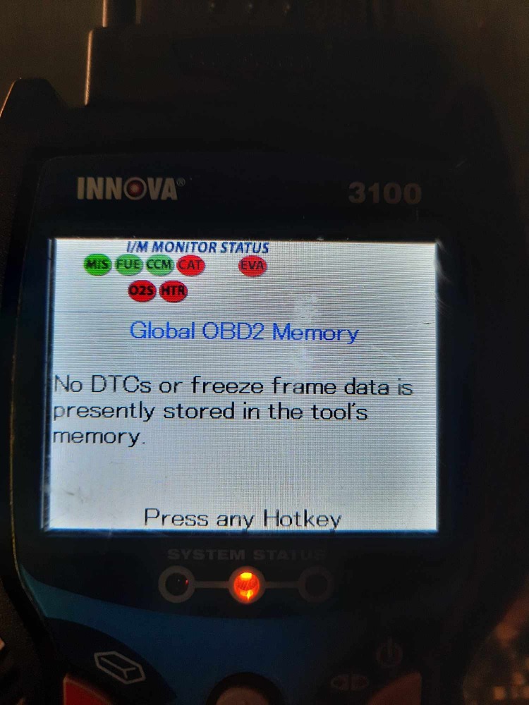

2 years 2 months ago #66606 by Jerry McGillis
Replied by Jerry McGillis on topic coil pack
[img]454469990_1747765292515447_2050918322872189827_n[/img]
have had thies for over 5 years, can they have anything with the problems i'am havein ?
