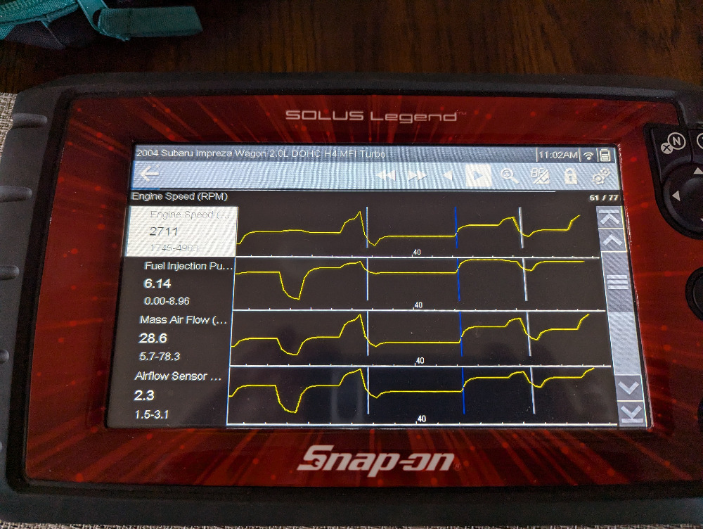

Have a weird hesitation that will happen on and off quite frequently. Check engine light is off, and recently the rate that it's been getting worse has increased. I have a scanner and when recording the data all of the parameters freeze at their last reading for a brief period and holds those readings until it goes to normal again. I have a picture of a scanner recording I will try to get that uploaded. I have no experience with electrical diagnosis and was just wondering if this is a clear sign of something? I don't know how to describe this issue so my searching on the forum/google isn't helping. Any help is appreciated

Here's a picture of when it's happening. All the parameters just freeze/flatline until they go to normal. Up above the 40 in between the first gray vertical and the blue vertical is an example, and also it happens briefly right after as well. In between the two gray verticals is acceleration in only second gear. If the flat lines were gone you'd see a normal second gear acceleration recording. What you see on the scanner is a direct correlation to what I experience while driving. Every flat line I stop accelerating. Backing off and on the throttle with small inputs does nothing. Coming completely off throttle is always normal and I can push through it by giving lots of more throttle, but sometimes it doesn't feel like it has its normal power, and other times it does
