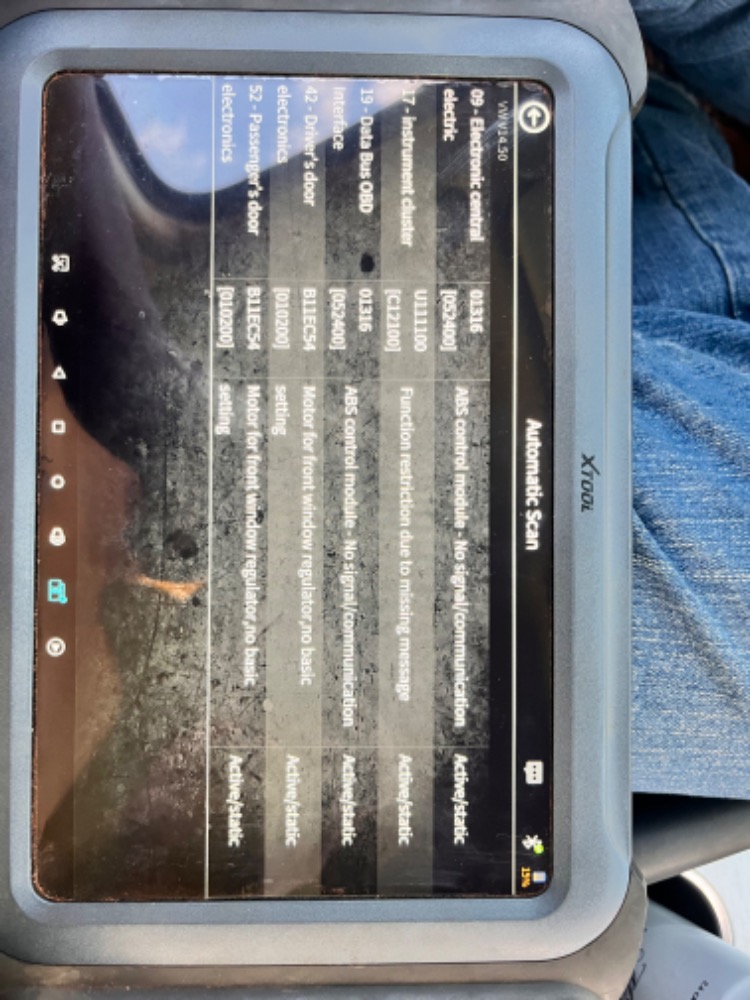

When shifting into reverse it loses all throttle response and end up dying out.
when shift back to any other gear idles raises back. You can drive forward any other gear.  Speedometer doesn’t work and fuel gauge goes up and down.  When checking can high low resistance it’s out of specification. Need help for next steps.
