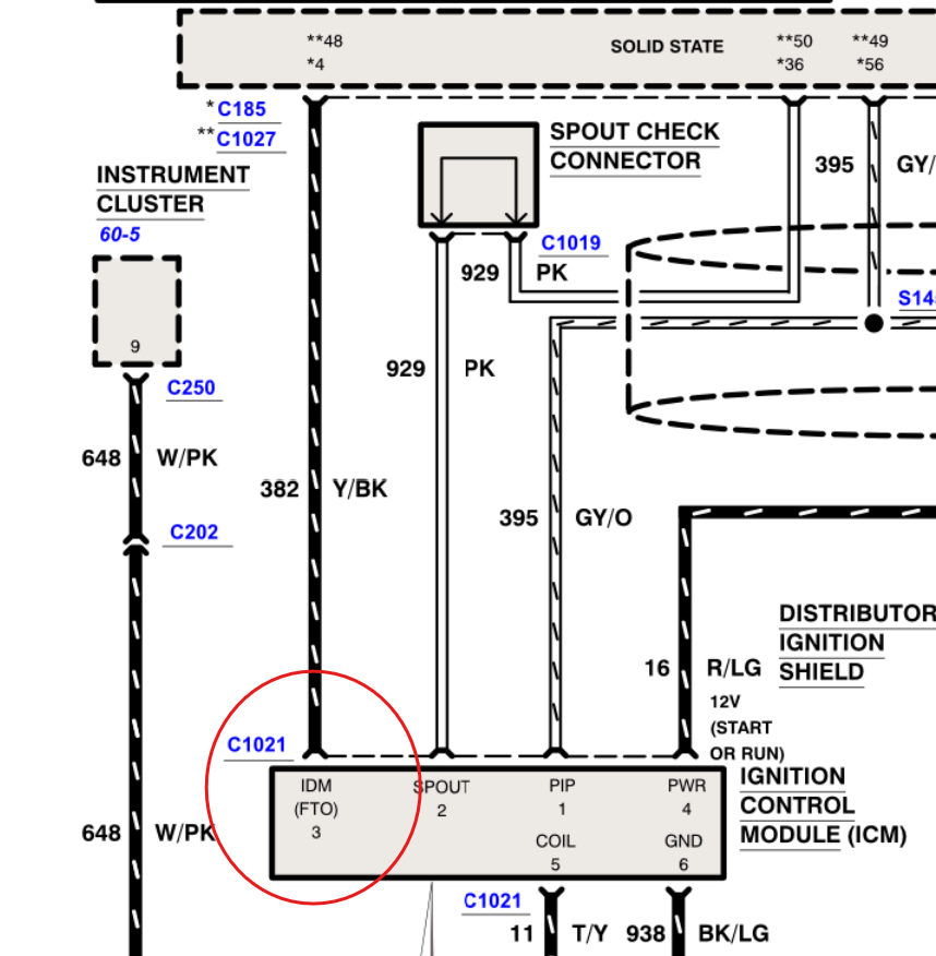

Hi, I have a 1996 f150 with a 5.8l and a e40d tranny. My symptoms are a interment missfire rough idle and stalling. Only dtc is p1351. I rebuilt the e40d myself and the engine is a crate motor from auto zone. I had the ignition issue before I put a fresh engine in it. I have done numerous things to this thing to no avail. I myself am a mechanic i own a tractor repair company I'd love for you to help me fix this truck!! I am very eager to get this thing fixed.

P1351 has specifically to do with the Ignition Diagnostic Monitor circuit:
Service info isn't clear about what the IDM signal should be, specifically, but I'm guessing it's going to be a square wave signal based on ignition primary events. I'd start by checking voltage on the IDM circuit first with the key on engine off, then with the engine running.
For what it's worth, service info also mentions that it's possible to install the wrong Ignition Control Module and get this code. You'll know by the color of the module itself. Black is the correct module, grey is not.

Voltages on that circuit you circled on the idm yellow/blk koeo constant 12v
Koer erratic reading down from 6v to 13v
