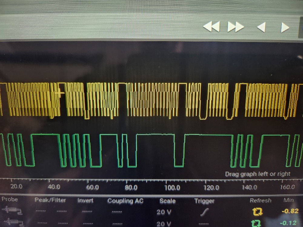

Getting Code P0335 - Crankshaft Position Sensor A Circuit. Scoped Crank sensor, seems to be dropping signal at the sensor, maintains good ground and 5v from PCM. Replaced sensor with OE part, same issue. Checked reluctor wheel on crank with borescope, looks normal. Any ideas what else this could be? Thanks for your thoughts!
Green trace on picture is intake Cam, Yellow is Crank.

Your crank signal, definitely, doesn't look right. I'm curious if the anomalies are, consistently, repeated. Or, if it is random.
I would turn on "Peak" detect, set your screen time for about 5ms, and re-capture.
After you record your capture, click the magnifying glass to zoom out. Post a screen shot of a little more than 720° of crank rotation and post a screen shot with many more rotations, to look for repetition.

Will try this tomorrow morning, seems to occur worse after heat soak so it takes a bit of time
