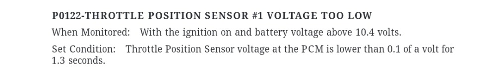

I wouldn't sweat the voltage range, necessarily. Not all TPS sensors will go to 4.5V at wide open. For what it's worth, the P0122 set criteria is pretty straightforward:
1.3 seconds is a long time for a TPS sensor signal to be stuck low. I'd also keep an eye out for a misrouted harness or a rubbed wire. The harness runs along the valve cover gasket bolts/studs, and it's easy to get one of the studs in the wrong place...

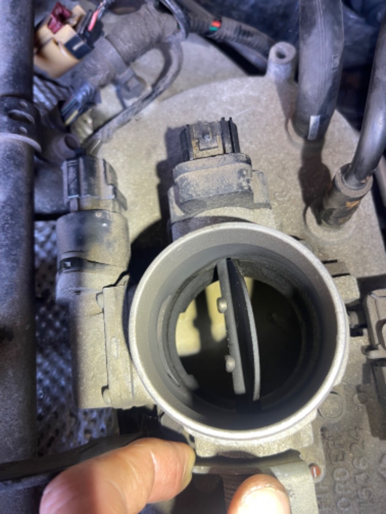

Thank you, Tyler! I cannot find any evidence of either heat or vibration damage to any of the wires. I hate to just be a parts changer, but I am going to go ahead and replace this TPS sensor while I am in here. I did notice some dirt in the throttle body. Is it safe to clean it out with throttle body cleaner with the unit still installed on Vehicle? Thx, Pop

Sorry I didn't get back to you sooner, Pop. You're probably way ahead of me, but yes, totally safe.
You might also see what reset options your scan tool gives you. That generation of Jeep had several reset functions related to idle, minimum throttle position and such.
