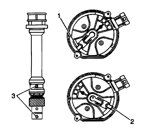

Dave here, I am having problems after replacing the intake manifold gaskets. I had a small water Ieak at the intake manifold and changed the intake gaskets and went to start it. The truck a 2001 Chevy S10 with a 4.3 auto.It cranks good and has a good charged up battery. I checked for spark, good, with a fuel P/T I got 55 psi. and it held for a good long time. I ohmed out the injectors and they all were within 2 ohms. I checked for injector pulse all good. My lights security light and dash lights all work and no check engine light or codes. I can smell fuel but no start. I have tried spraying starting fluid into the intake hose but still no start or want to start. Need help.

I am assuming the coolant leak was from the lower intake?
I don't think coolant goes anywhere through the upper, but it's been a little while since I took one apart.
I'm wondering if distributer had to be removed.
I'm thinking the distributer could be stuck wrong or the wires misrouted.
I'm not criticizing your work, just looking at the pieces you gave us to work with.
All the inputs seem like they're present if you have spark and injector pulse. Plus you smell fuel and starting fluid didn't fire it up.

9 years 2 months ago #11737
by carguy123
Replied by carguy123 on topic 2001 Chevy S10 2 w/d 4.3 Auto Cranks good, good spark, 55 psi fuel and holding,
Im with Noah, I Did a 5.7l and was 1 tooth off and I played hell getting it started.... you can ck on scanner pid to see if is advanced/retarded there are very sensitive .
good luck!
