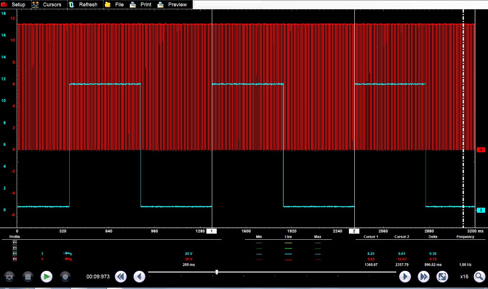

Already checked for Fuel, Spark and RPM signal. Only thing missing is fuel pressure at the rail. My question is, while checking the Fuel Pressure Driver Module FPDM I found that I had no duty cycle signal on the FP_M wire (DG/Y) with either the KOEO or while cranking. Another thing is the fuel pump ground wire BK/PK is only dropping to .9v while cranking. Any ideas on this before I switch out the FPDM. Thanks

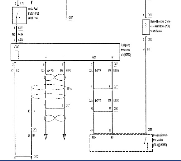

did you check for power on the pk/bk wire from the inertia switch??

Sorry, you know how I love my wiring diagrams.

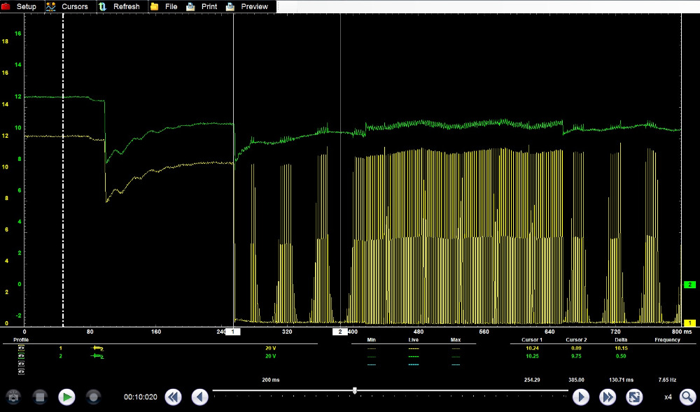

Seeing .9V on the pump ground isn't so unusual on this system, because it FPDM still uses a pulse width control even during cranking. It's not a complete ground, and your meter reflects this. The fact that it IS pulling down to .9V is possibly a good sign for the FPDM, as it shows it's trying to run the pump.
This capture of a similar FPDM shows the pump control used during cranking.
Are you positive there was no activity on the FP_M wire? I ask because it's a pretty slow compared to most square wave signals. Here's a shot of the FP command signal in red, and the FP_M signal in blue.
A complete cycle takes one second, so your DMM might struggle to recognize it as a duty cycle.
Since it looks like the FPDM is controlling the pump, I'd suggest checking the pump feed, white red. It should be steady B+ any time the key is on or cranking. If you find power, then I'd suspect the pump itself. You can confirm this by wiring a headlight or other substitute load across the pump power and ground terminals at the FPDM.
