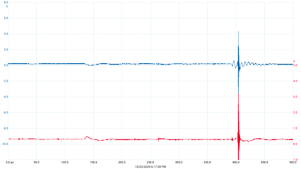

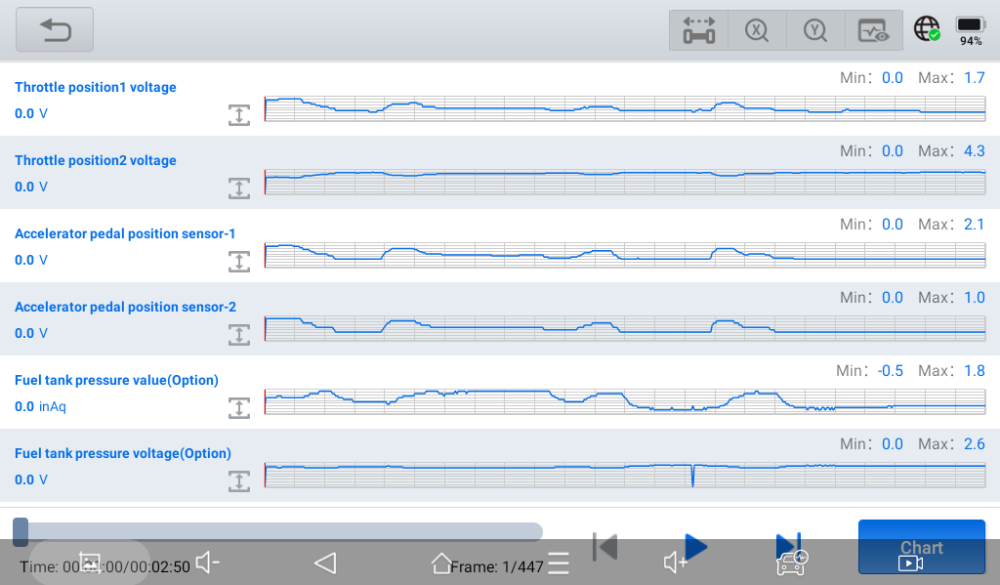

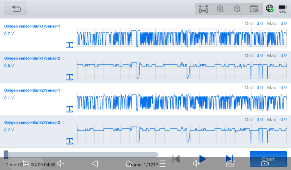

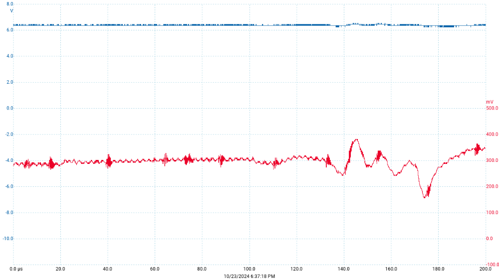

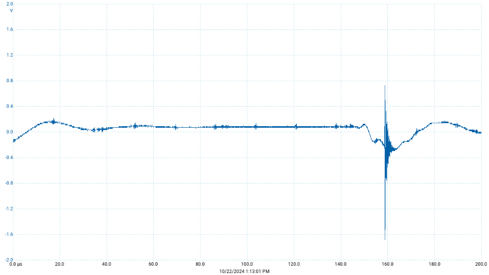

Hi all I'm working on a 08 hyundai santa fe 3.3L. I was checking pcm grounds because I have a very intermittent loss of sensor signal on my scan tool. I've seen it on tps, app, o2s, fuel tank pressure voltage. It caused a stall while driving but hasn't stalled since even though i see the dropout on my scan tool. No codes. My question is when I checked the ground (car idling) for the fuel level sensor/ fuel sending unit it was around .3mv. I then checked the signal wire an it was 6.1volts. I shut the car off left the key on an the voltage on the ground wire slowly crept up to about 2.5volts. If I start the car it slowly goes down to .3mv. I'm guessing this is right since I don't have any codes and my fuel gauge seems to work but this doesn't make sense to me. Has anyone seen this before?

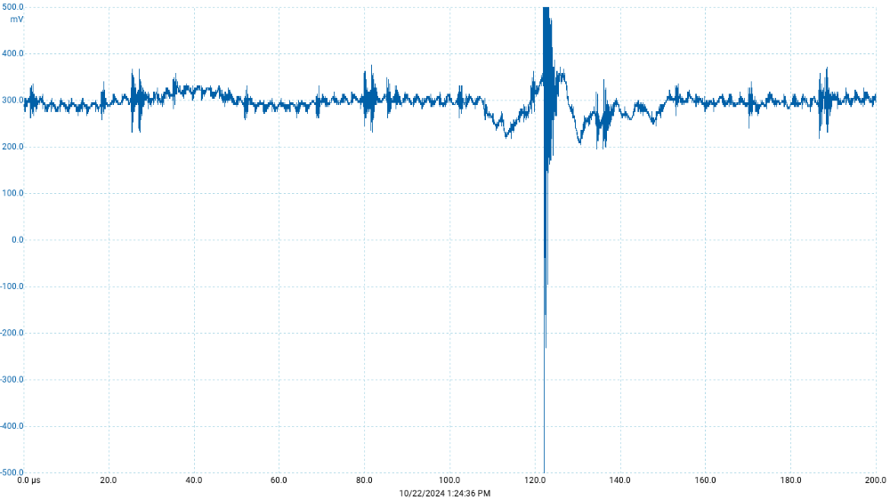

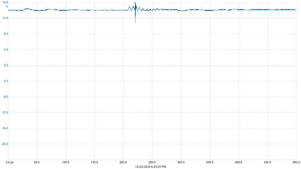

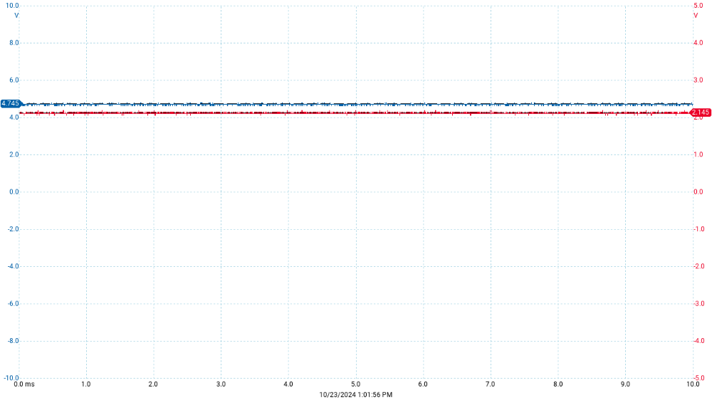

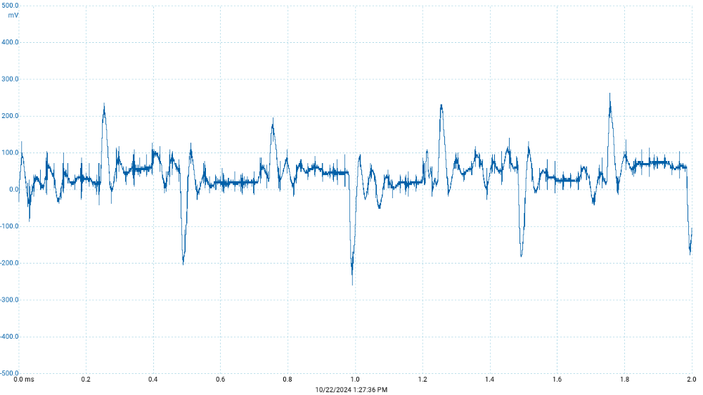

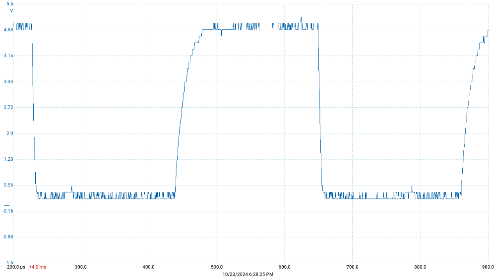

I didn't think to check the pid at the time but the gauge didn't seem to have fluctuated at all and the pid an gauge when i check them seem to be in agreement. I can't post pics at the moment but all the grounds on the c130A connector seemed to have spikes or more erraticness compared to the grounds on the c130b. I did check where the computer grounds to the chassis didnt see any voltage drop. I'll try to post some pics later.
- Chazz1994
- Posts: 7
2 years 1 week ago #67395
by Chazz1994
Replied by Chazz1994 on topic Fuel level sensor
some scope pics of grounds and what appear to me to be faults.

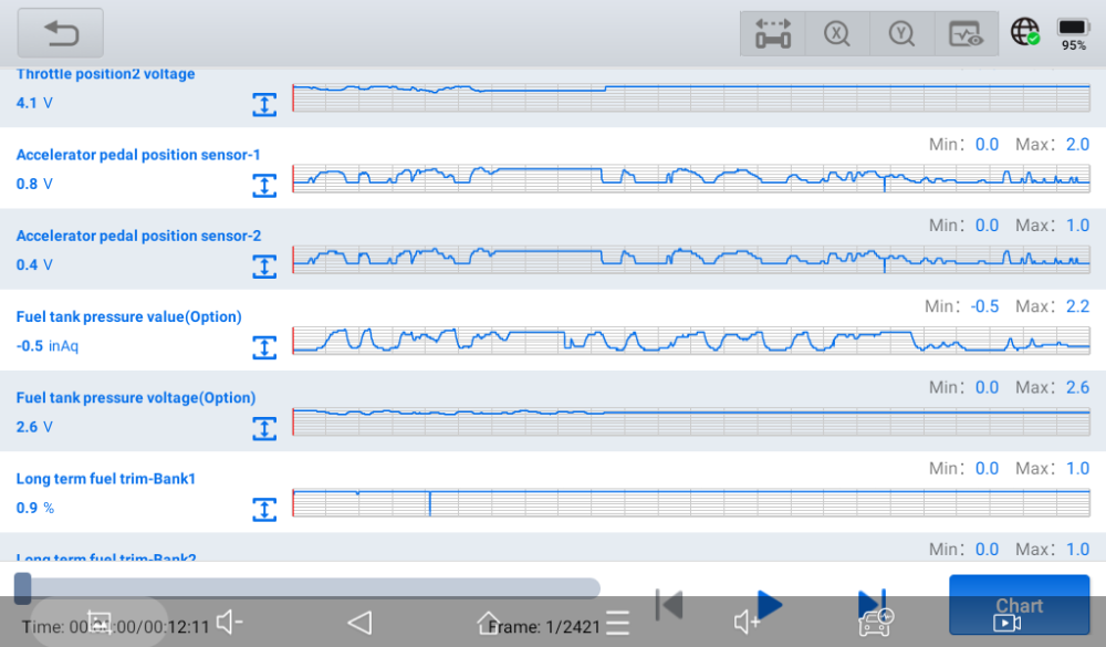

2 years 1 week ago #67396
by Chazz1994
Scantool dropouts
