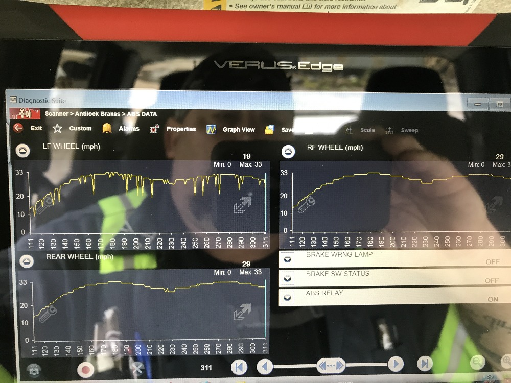

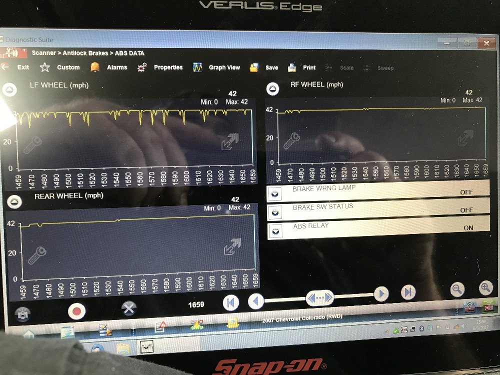

07 Chevy Colorado getting a left front wheel sensor error don't remember the code replaced front hubs left and right front sensors left and right making sure left sensor went to left side and right sensor went to right side I included two attachments screenshot I have no wiring diagrams 07 Chevy Colorado 2.9 L two-wheel drive standard suspension I did use my lab scope had good signals where I back probed at the wheel speed sensor connected to the chassis electrical harness

Are those pictures of scan data? The LF is awful glitchy. Did that show up on the scope too? I second Tyler's suggestion, wanting to verify air gap and tone ring integrity.
If that all checks out, I know Chevy liked to mount the abs modules on a frame rails under the truck for just about everything. Not a great home for electronics in my opinion, but what do I know?
A visual inspection of the connector and module, then check the signal from the wheel in question right at the module may be in order.
