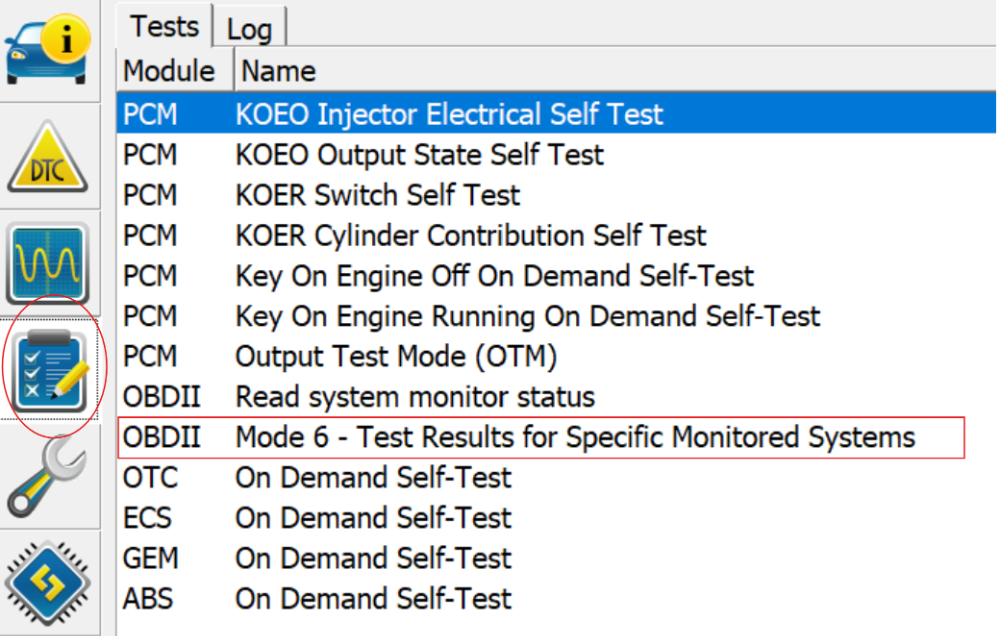

First thing that caught my eye was the fuel trims, about -15% total on both banks. Trims improve slightly off idle. Made me wonder if the MAF is misreporting, but it's tough to gauge with the engine still warming up. Would you be willing to recheck trims and MAF g/s with the engine fully warmed up?
You can definitely hear the sputter during a throttle snap. Makes me wonder about a secondary ignition issue. Even if you don't have any fault codes setting, you can still check the Mode $06 results for misfire counts. Forscan makes this easy. In the 'tests' tab, use the 'Mode 6 - Test Results for Specific Monitored Systems' option.
Grab a screenshot of the results, if possible.

I attached another link to the video and hopefully was able to get enough information for you as far as the mode 6 data and truck fully warmed up.
