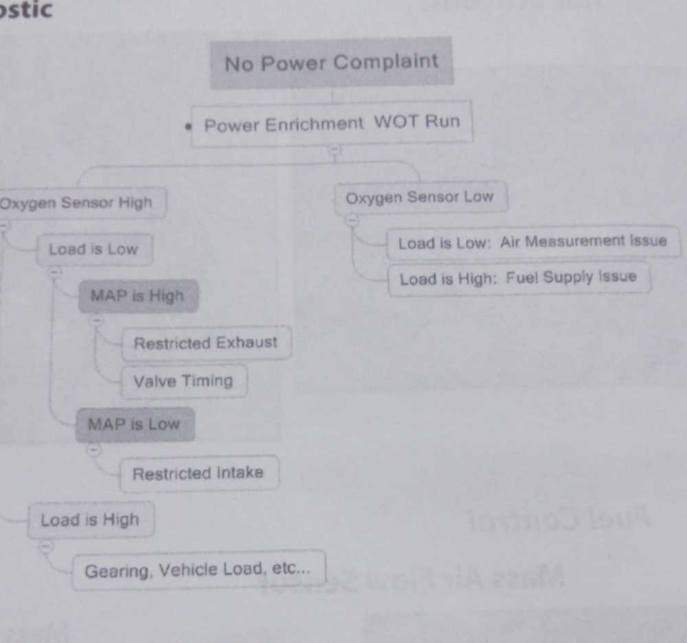

9 years 11 months ago #1858
Replied by Tyler on topic P0171 - 2008 Mazda 3
Found a picture of a flow chart I found in a training manual, thought I'd post it in here for anyone following along. I really like this chart, because it takes the WOT O2 test that ScannerDanner uses, and adds Load and MAP PIDS into the equation.
My thought process was following the 'Oxygen Sensor Low' path, but it was challenging for me to 'see' that in the data captures. Not that you were doing anything wrong, I'm just used to working with enhanced OEM data, instead of Generic OBD. That's why I had you working with the Equivalency Ratio and such.
But with the high Load reading, the chart points directly to a fuel delivery issue

I like that flow chart! I saved it for future reference.
