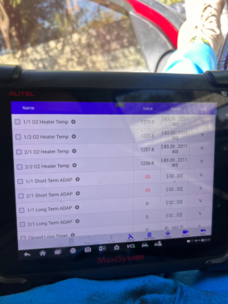

Hello everyone. I need some help with this codes.
parts that someone change.
All 4 denso. 02 sensors.
Champion spark plugs.
air filter.
Pcv valve.
what i check already:
fuel presure. 60psi. Engine running ( manual gauge installed )
Vacuum leak. (Pass)
injector pulse. ( all. From 920 to 1200. ).
Purge solenoide (Pass). Not stuck open )

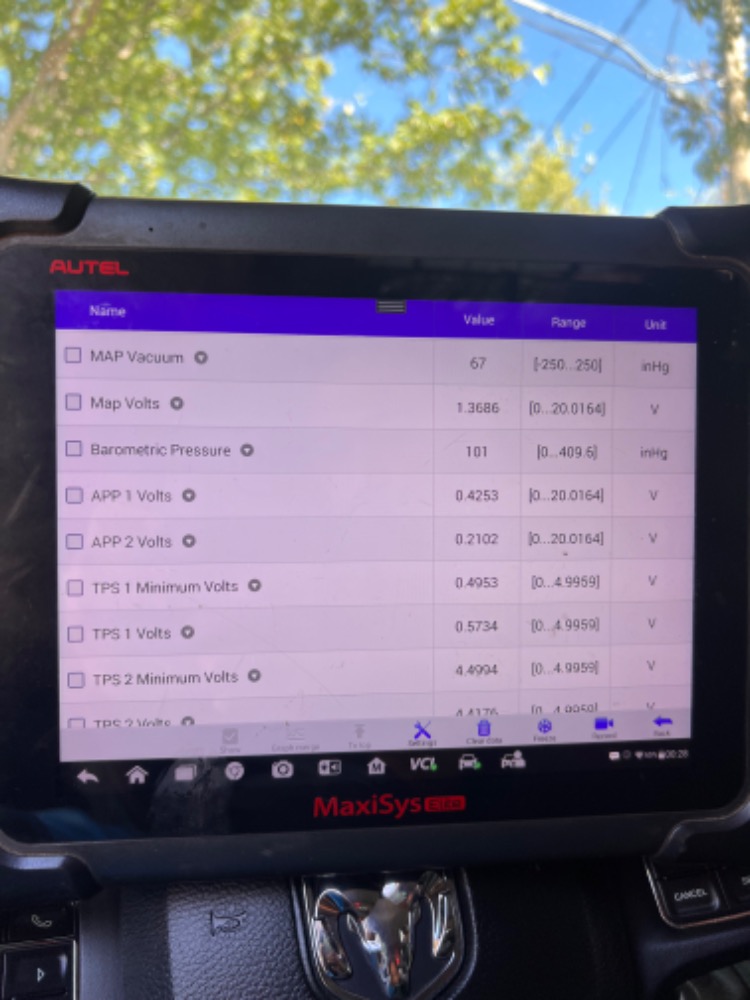

➡️➡️➡️ my map sensor. Shows 32 psi. And barometric pressure. 49. Voltage 4.5-5 v ignition on And 1-2v engine running Are this out of spec?
my stft1 and 2. Stuck on -33
my ltft 1 and 2. Stuck on 0
any input or advice will help. Thank you so much. ⬇️⬇️⬇️ some pid. Pictures.

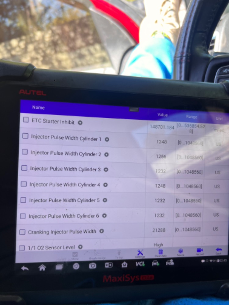

I don't understand the results of the fuel injector test you describe, could please explain in greater detail?

Hello. What i mean is the injector width pulse. This is what shows.

Yes only stft get better. And drops to 5-0 When i go wide open throttle. Then goes back to -33 But ltft. They dont move. They stuck in 0

I did a ecu reset. And now. The. Ltft are stuck at -33 and stft. Are working. From -8 to +7 And i take the injectors out to. Check the spraying pattern. And they look even. Im lost *****do you guys think. There is any way. That the ecm need update. To fix. This. Codes. ?????

Hello yes i check map sensor itfs 5v switch on engine off. And running is 1.4-1.9 v.

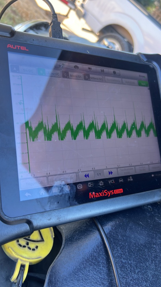

I remove the injectors With tthe fuel rrail and crank it. And. They look. Even. I will left a picture of the pids. … no map on this 3.6. I check temperature sensor. And air temperature sensor. All 4 02 sensors are new. Denso brand. Got new spark plug champion brand. New air filter.

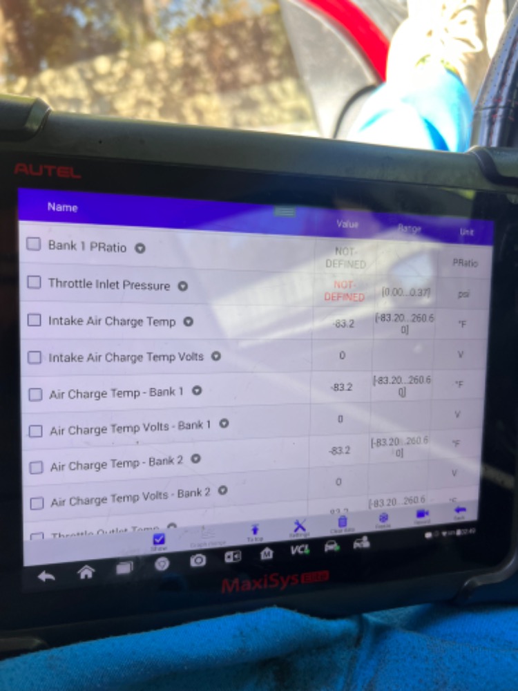

Fuel pressure is 60. Compression look. Even. I will left a picture. (Is a noise wave form thats the clean i can get ). And on the last picture. I not sure what its show. The red pids. For the throttle body. ➡️do i have to worry About this??……Any a idea. What i can check i will appreciate 🙏

I don't know much about the Throttle Inlet Pressure pid. From what I have read, it provides ambient pressure reading to the engine computer. I would investigate it further if I were you.
