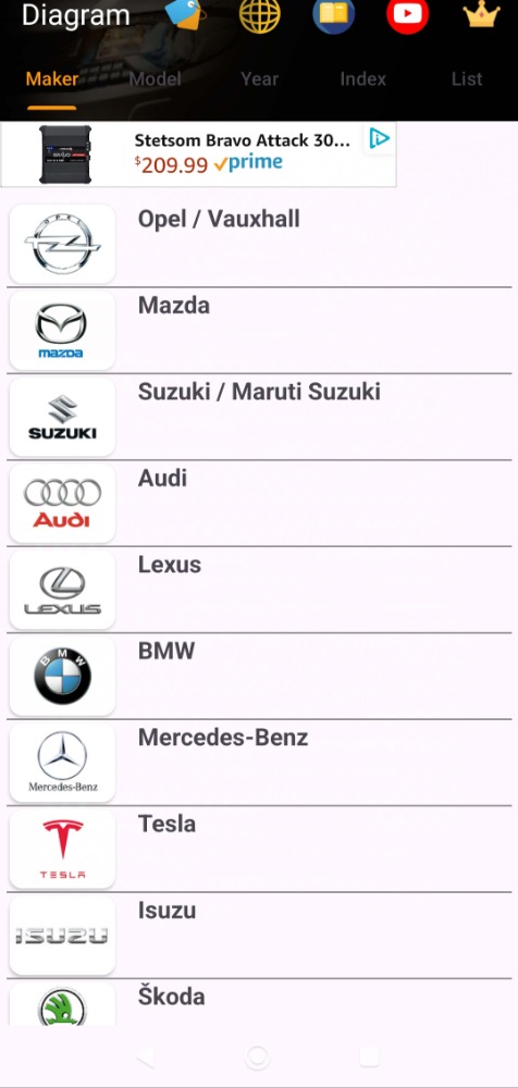

You may find the wiring diagram in the free Carmin app. Both 4 and 6 cylinder engines are covered there I believe.
Because of dealing with direct injection it's NOT probable that it's just a simple short to ground. These injectors are both hi and low side controlled.
No offense ment but you may consider to take your car to a knowledgeable mechanic.

You'll find the Carmin app in the Play Store.

Thank you so much this app looks perfect. I would love to hear more about how these injectors are controlled. I thought it just sent a simple 5v pulse to open the injector. Are these designed differently?

These injectors are pulsed, but with peaks of probably 60 to 80 volts on the positive side and they are also pulsed on the ground side.
