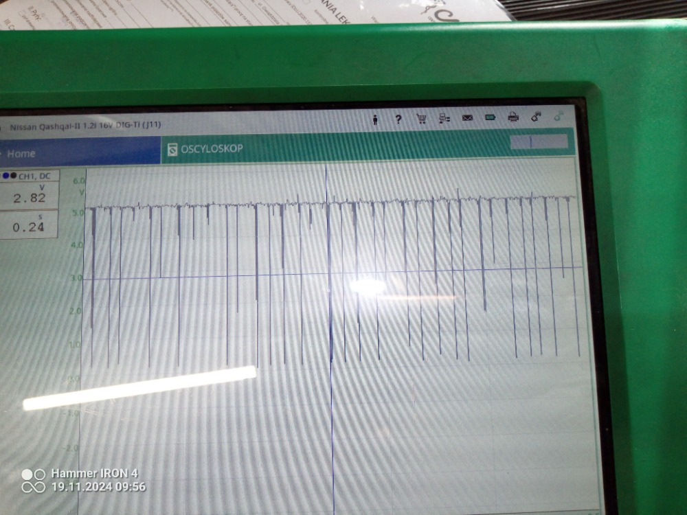

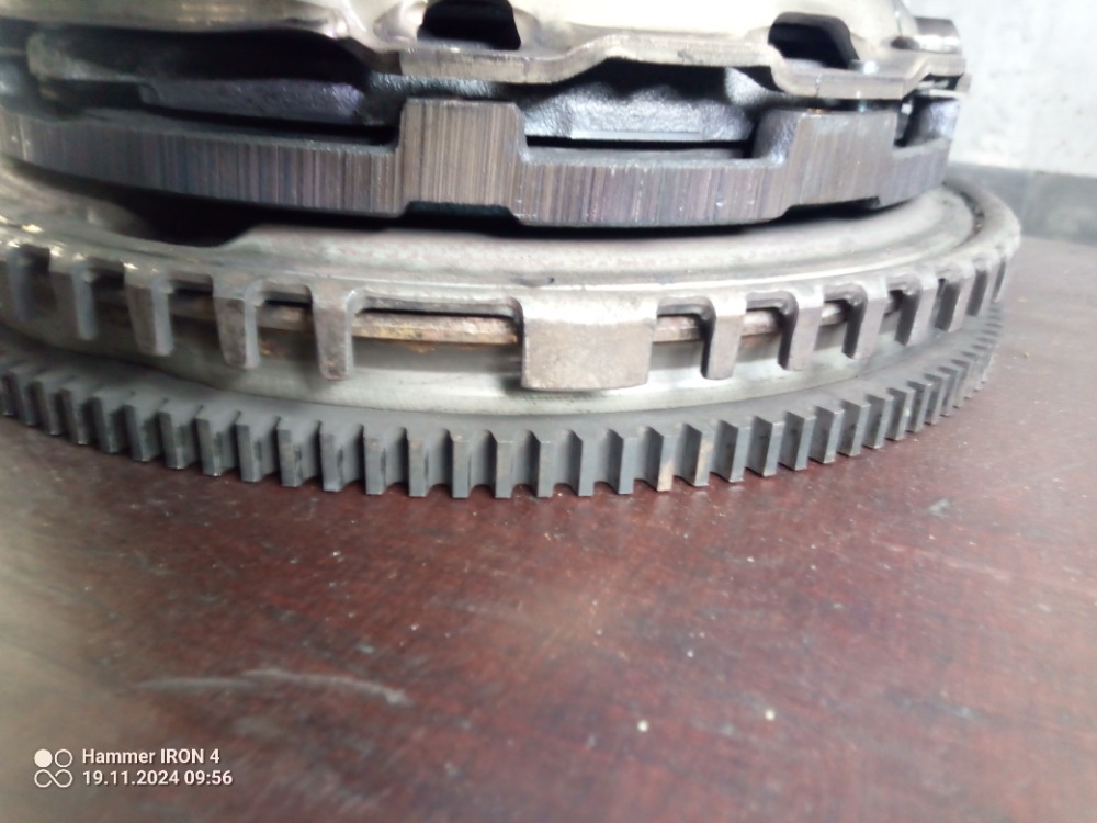

1 year 11 months ago #67701
by Farseer
Replied by Farseer on topic Are all Hall effect sensors supposed to generate a magnetic field?
Well, I'm unfortunately very confused...
The no start turned out to be a jumped timing chain on the exhaust cam.
When I took the cover off, the chain was hanging (!) Slightly from the crank sprocket. You could make the chain move from link to link that's how bad it was. When tightening the flywheel bolts, I must have turned the wheel clockwise, which would have turned the engine counterclockwise jumping the loose chain.
But that still doesn't make sense. I just cannot explain why the crank had no signal... After it fired up, I scoped the sensor and now there was some activity, just nothing comparable to the camshaft sqaurewave...
Kind of annoying, really, because that really threw me down a path of thinking the crank sensor was faulty.
A very unsatisfying result. I'll post some pictures and maybe someone could explain it to me, I'd be very grateful. Maybe the flywheel has so many teeth you can't pick them out on a scope? Although... That makes no sense.
Btw, the scope is zoomed in the way and you can't make out any details. It's on the same time base as the camshafts. Although, changing the settings did nothing.

- Farseer
- Posts: 43
- Thank you received: 5
1 year 11 months ago #67702
by Farseer
It's even weirder that I couldn't get the sensor to activate when putting something metal in front of it as I could with the cam sensors...
