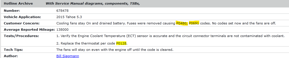

1 year 11 months ago #67819
Replied by Noah on topic 2017 Chevrolet Suburban 5.3L Cooling Fan stays on
P0480 and p0691 are fan circuit codes and may have been set by pulling the fuses to stop the fans.
P0128 indicates the engine took too long to reach temperature.
When this code sets on GM models, the fan defaults to high and the temperature gauge may stay at it's lowest position.
Assuming the coolant is full, this code generally sets when the thermostat needs to be replaced.
I like to disconnect the coolant temp sensor and make sure the voltage PID goes to 5v to rule out resistance on the temp sensor signal wire, then change the thermostat.

1 year 11 months ago #67821
Replied by Tyler on topic 2017 Chevrolet Suburban 5.3L Cooling Fan stays on
Hey pop! Like others said, thermostat time. Try to get an OE one if possible. MotoRad is OK if not.
Eyeball the heater hose quick connects while you're there. They like to start leaking at higher mileages.
