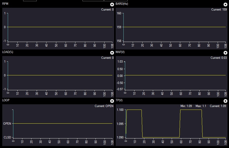

Was hoping someone could enlighten me about something I witnessed on a Focus in the shop recently. FYI, this vehicle has come and gone, so I won't be able to do any follow-up testing :( I'll answer any questions as well as I can.
'01 Focus comes in with a stalling complaint, and a check engine light. P0171 stored. Freeze frame has vacuum leak written all over it. A test drive doesn't reproduce the stalling, but I can easily see how it could be:
www.scanshare.io/share/YOfrRs-7eEehJIA2LlOlJQ#0,1,7,8,12
Oh yeah, 70% total correction at idle! I find a big ol' vacuum leak at the EGR valve that's been loosely installed with the wrong bolts, and no gasket. Yep, someone hacked this one up before I got to it. I noticed the abnormally high BARO reading, but decided not to read much into it given the other problems.

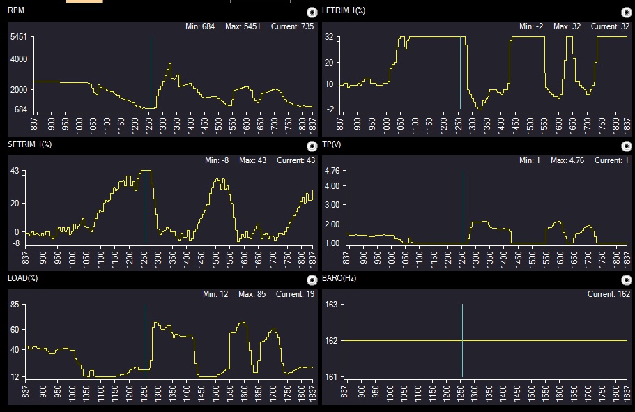

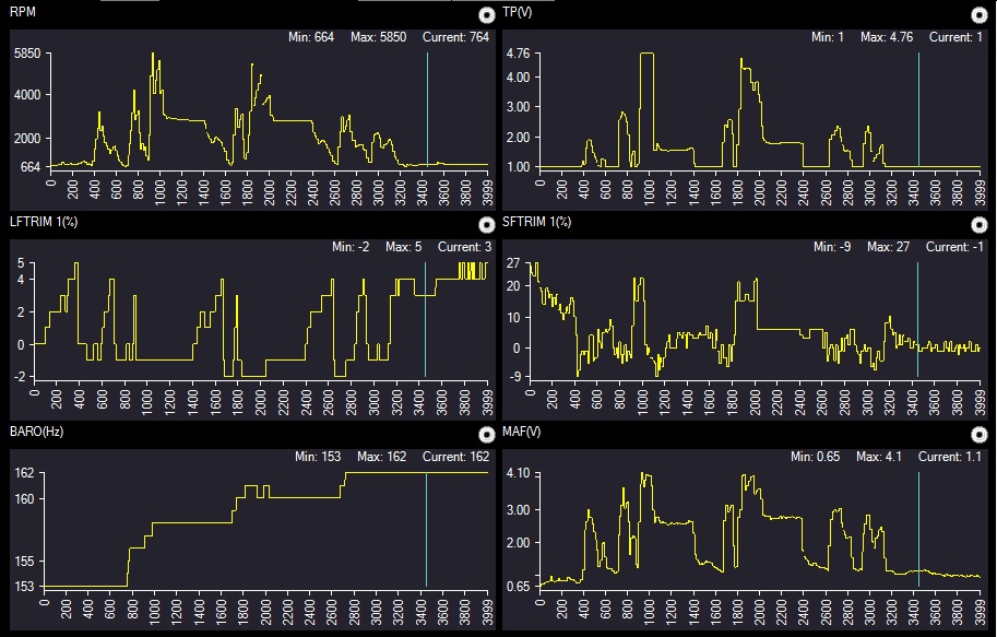

Fixed the EGR valve, clear the KAM and I go for another drive.
www.scanshare.io/share/tHRtAg7SJUKoQcKzn5n93g#0,2,6,13,14,19
Fuel trims are much better overall, but the BARO ends up high again. A BARO of 155 to 157 Hz is normal for my elevation, so a reading of 162 Hz is very strange. For reference, that reading would be normal if I were below sea level, instead of above.
This is the first time I've ever seen an abnormally high BARO reading. Normally, a breathing issue or a under-reporting MAF will produce lower BARO readings, so I'm not quite sure what to make of this. The engine is breathing TOO well? :unsure:
I'd be happy to hear any thoughts you have as to why this Focus thinks it's in Death Valley instead of Kansas!

It starts out OK after the repair and the KAM is cleared. At the time of the "correct" reading, STFT is high, but is soon countered for by LTFT and everything seems to settle into an acceptable range. MAF looks to be reporting within range at WOT (what I assume is WOT by the TPS anyway) maybe a smidge low....
I've been trying to draw a correlation to the Baro PID update to MAF and TPS values, but they aren't consistently changing together....
Very curious...

Yeah, I noticed how the trims started out too high, then worked out once the Baro and long term started learning. I've never seen a Ford with a weighted LTFT value, so I think the Baro is indeed playing with trims. It just so happens to be in the right direction, lol.
Matt, fair question, I actually don't remember what the DPFE was reading during the test drive. I can't view ScanShare.io on my phone, but I think that would answer a lot of questions about the EGR system. I'll check back later.
Exactly right about the Baro frequency. If I'm thinking about it correctly, then a higher barometric pressure would require more fuel to match the denser air.
The Baro PID updates (going higher), computer adds more fuel, trims go closer to zero. So then, the engine would actually be lean if the Baro would update correctly...

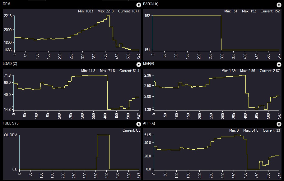

Update outa nowhere!
Just thought I'd share some other data I gathered. Had a different '01 Focus in the shop recently, oil change and A/C concern, no driveability problems. Just HAD to take a peek at the Baro reading:
Also on the high side... Makes me wonder if there's something about this engine application that causes that?
Then yesterday, diagnosing a misfire on an '04 F-150. The Baro didn't have much to do with the problem, but I took a glance anyway:
Little bit low. Again, no breathing problems that I'm aware of.
Honestly, I'm not very confident in the Baro calculation any more. Not that I placed a ton of faith in that PID in the first place, but it seems like there's too many variables at work to get a consistent Baro calculation. Any thoughts/comments you have would be welcome!
