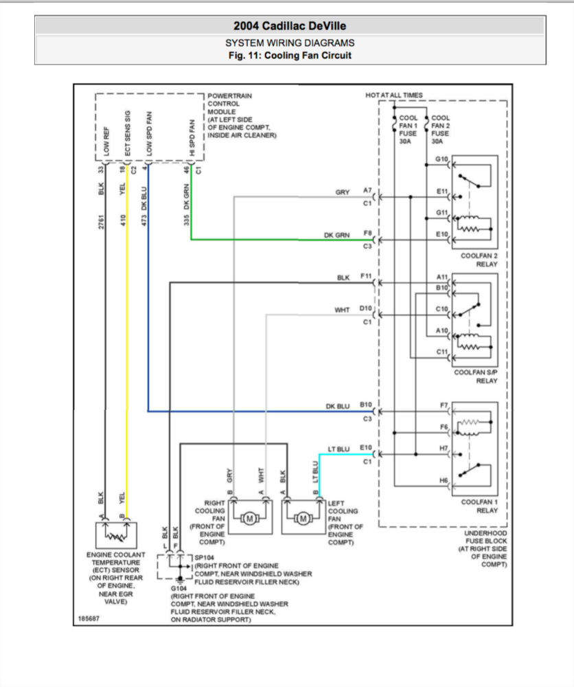

Can anyone explain how the control side of the COOLFAN S/P RELAY can ever get grounded.

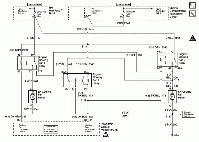

An error in the redraw?
Try this one.

That one does make more since. But I dont think it’s the right one. This deVille definitely has 2 30 amp fused running the fans.
