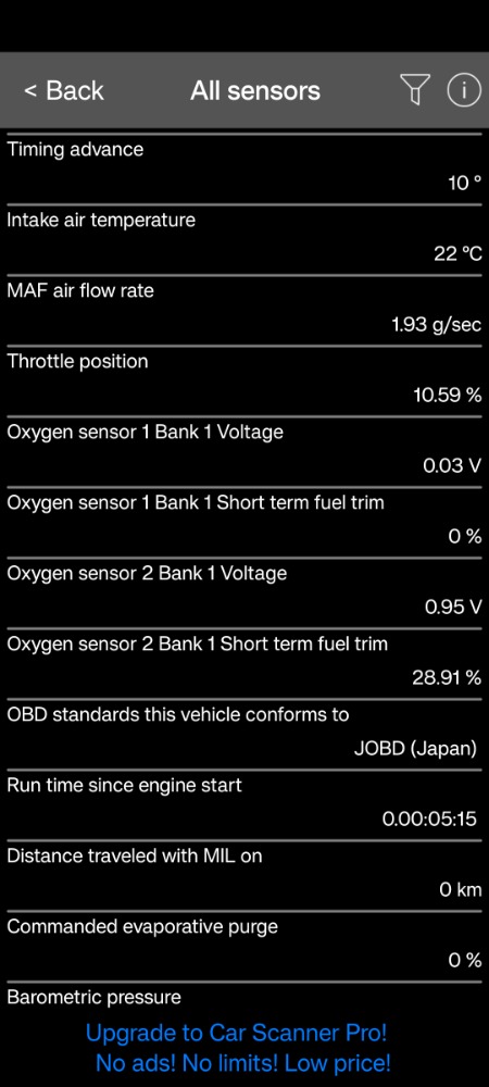

1 year 10 months ago #70994 by muhammad.asim
Replied by muhammad.asim on topic I keep on getting the P0130 code.
Turns out , the engine is running rich, being a Toyota family product the first O2 is a A/F sensor which is reading 0v-0.07v and the second 02 is reading close to 0.9 which indicates a rich condition. But now what should i diagnose to fix the rich condition ??? MAP sensor is also reading close to 2g/sec at idle which is normal.
  • muhammad.asim
  • muhammad.asim's Avatar Topic Author
1 year 10 months ago #70995 by muhammad.asim
I swapped the O2 sensors positions and both works O2 sensor 2 still reads 0.9v and 02 sensor 1 reads 0v-0.07v.
1 year 10 months ago - 1 year 10 months ago #71005 by Monde
Replied by Monde on topic I keep on getting the P0130 code.
If the front sensor is a wideband sensor(A/F), the rear one is most likely a narrow band sensor. There were no need to swap them.
The reading of the 0- 0.07v of the A/F sensor and the 0.9v of the downstream suggest that there is an issue with the front sensor or its circuit. The pcm is adding fuel due to the low voltage from the front sensor causing the rear sensor to go rich. If you disconnect the sensor, do you see a bias voltage on the scanner? If you rev it up to warm the sensor, do you see a change in the front sensor voltage, which would suggest a heater problem?

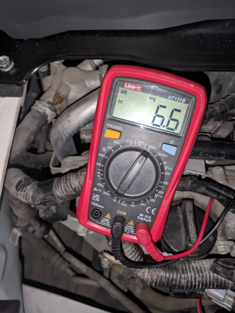

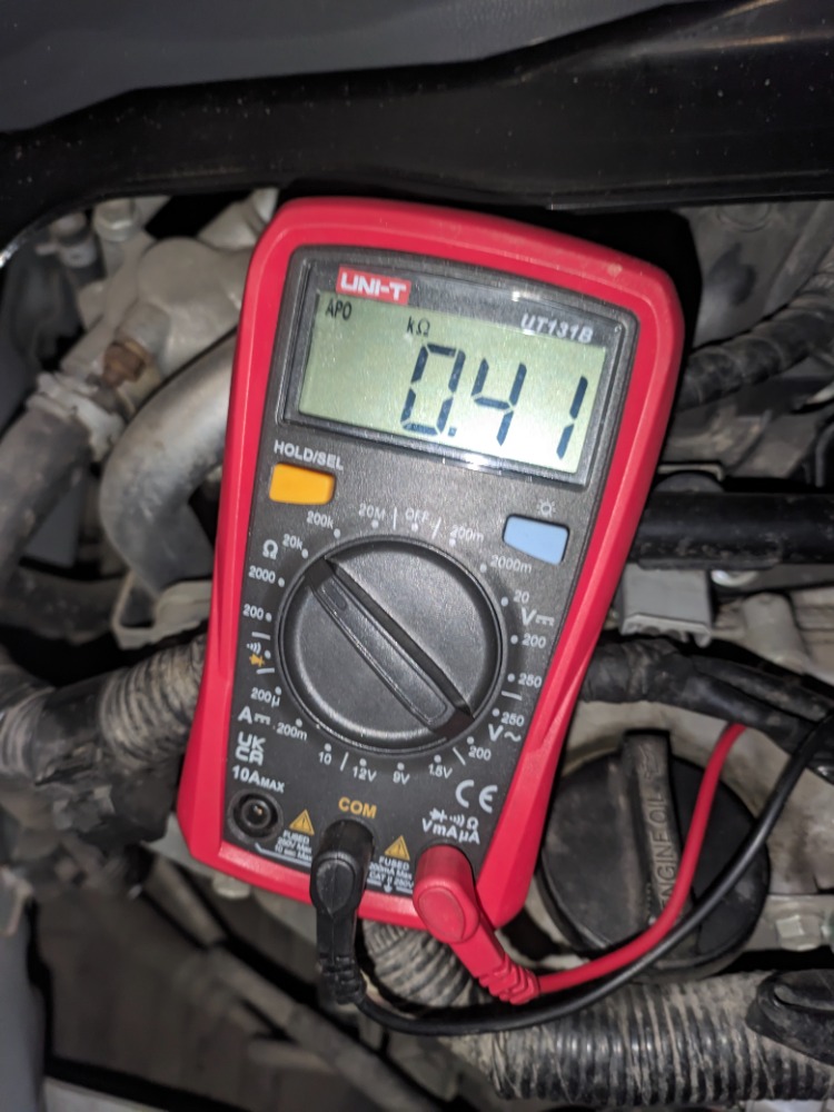

1 year 10 months ago #71058 by muhammad.asim
So, I couldn't wait for tomorrow as i use the car daily and its been drinking a lot of fuel... I checked for the bias voltage (6.6mv)and checked the resistance(0.41kohms) in the o2 sensor circuit. I did it with the car switched on and o2 sensor unplugged.
1 year 10 months ago #71134 by Monde
The bias voltage can be checked by unplugging the sensor and looking at the voltage on the scanner.
The voltage drop should be done with the sensor plugged in. Does the vehicle have 2 banks? If yes, try swapping the front sensors.
You can use a test light to load the ground a little.
