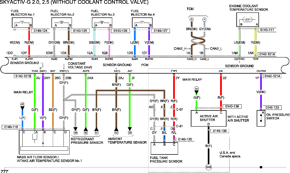

I have a 2017 Mazda CX-5. The ftp sensor has 2.6 volts output at the sensor but the scan tool shows 0 volts. I am getting a p0452 code. I’m using an Otofix d1 lite scan tool. Where should I look next? I can’t find any wiring diagram on google.

Does anyone have access to a wiring diagram to verify the PCM pin connection to the Fuel Tank Pressure Sensor? I think it goes to pin 2Y. Is that correct?

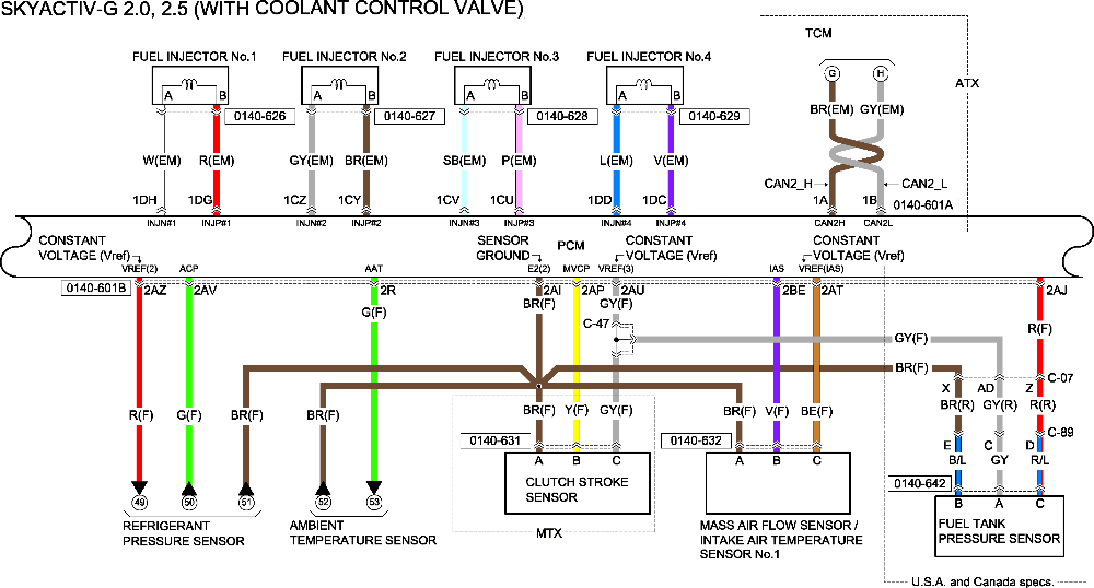

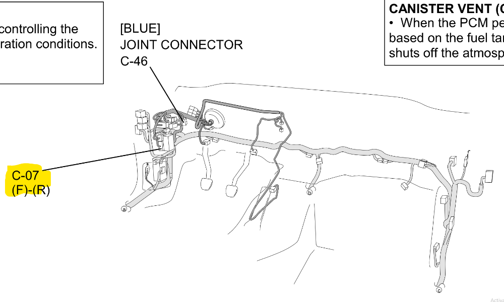

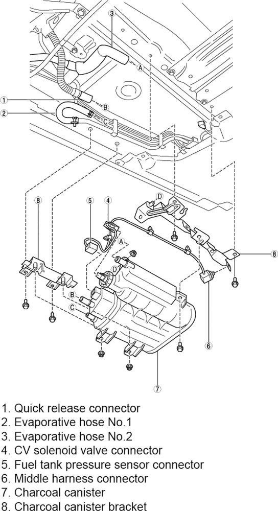

1 year 11 months ago #67939
by ferris48
Replied by ferris48 on topic 2017 Mazda Cx-5 FTP sensor
2AJ with coolant control valve, 2Y for without coolant control valve and there are 2 connectors from sensor to PCM. See attachments.

1 year 11 months ago #68012
by johnddawson
Replied by johnddawson on topic 2017 Mazda Cx-5 FTP sensor
Thanks for the diagram but the wire colors don’t match. There was no gray wire . The brown wire was the only color correct. Do you have any other diagrams for 2017 Mazda CX-5 2.5 engine py?

1 year 11 months ago #68016
by ferris48
See attachment for redrawn color diagrams unfortunately that's all I have to offer.
- johnddawson
- Posts: 4
1 year 11 months ago #68017
by johnddawson
Thanks for the diagram but the colors don’t seem to be correct.
