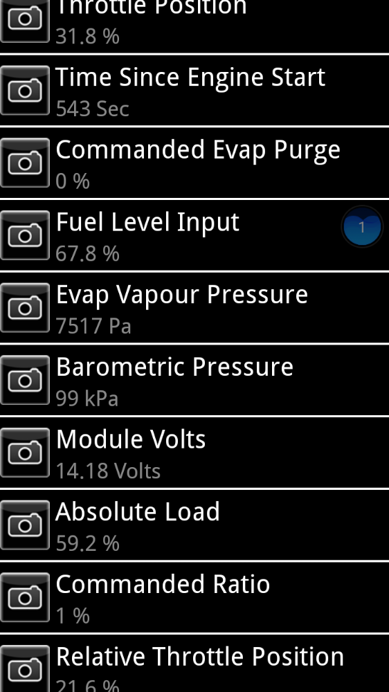

Does the 2014 Chrysler Town and Country use an oxygen sensor or air fuel sensor? Also are there one or two banks on this car?
Friend has a P0 420 code and I'm trying to help him out with that

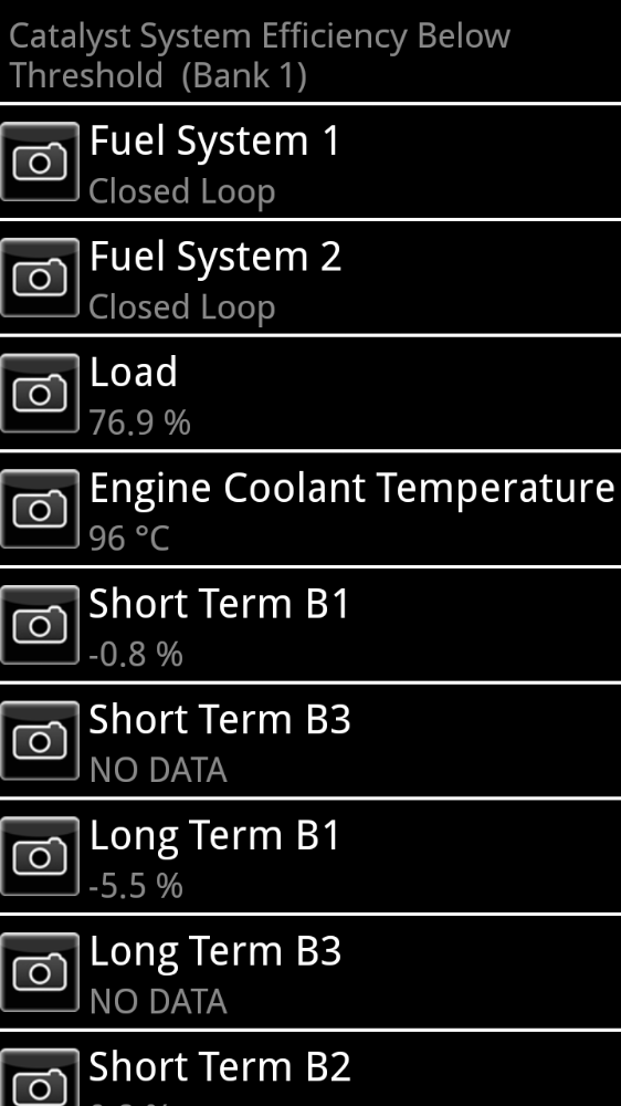

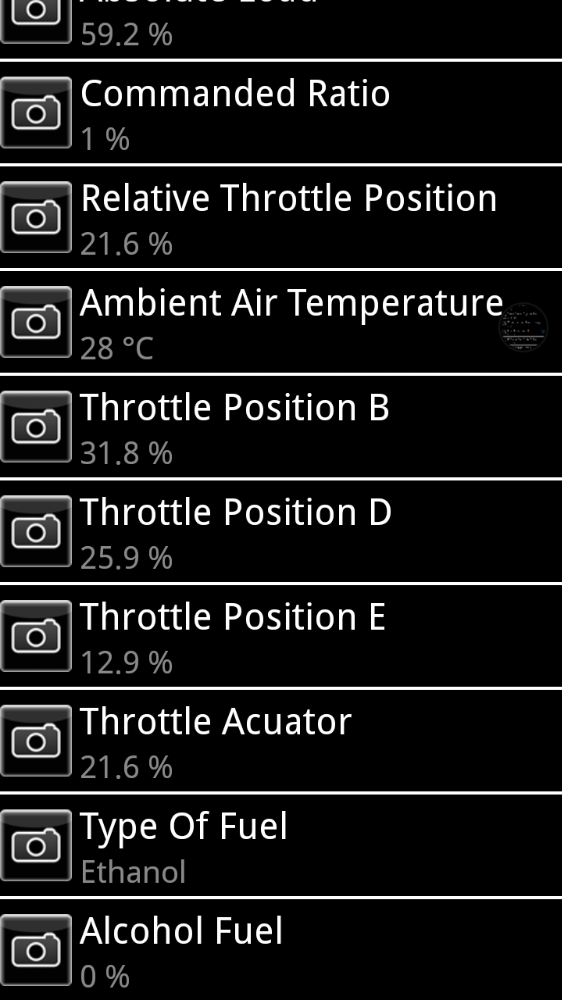

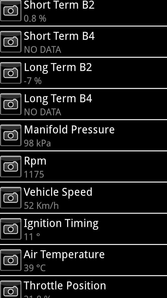

9 years 2 months ago #11802 by Donnyten
Replied by Donnyten on topic 2014 Chrysler Town & Country question
Thanks.
I'm looking at the freezer frame data and some things don't seem right.
What exactly is absolute load vs load? Which value should I be paying attention to?
What would cause the engine cpu to assume wide open throttle? (if I'm reading it right) the data pid's *baro pressure and * manifold pressure says the throttle oursude/inside pressure is the same..
RPMs are relatively low so that doesn't add up either.
Not sure if I should be reading throttle position or relative throttle position. Either way they don't add up
There are no driveability issues but I plan to test drive tomorrow.

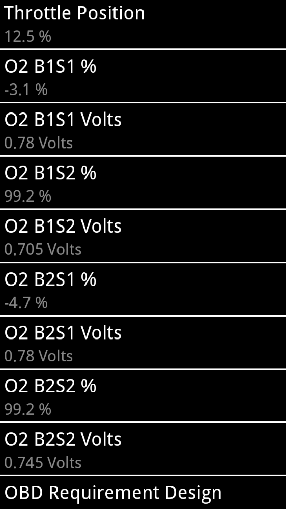

The photo posted in the first post was engine at idle, parked.not sure why the o2 data wasnt captured in the freeze
Thoughts welcome.
9 years 2 months ago #11805 by The Auto Tech
Replied by The Auto Tech on topic 2014 Chrysler Town & Country question
Monitor the bank one upstream and downstream 02s. Upstream should vary approx .1v to .9v downstream should remain relatively constant.
raise the rpm to 2500 and watch the 02s if they are mirroring each other and there is no other drivability concerns such as a misfire it would suggest a bad converter.

Looks to me the downstream O2 sensor is at fault. The downstream is a little jumpy however is not mimicking what the Upstream is reporting. No other drivability symptoms noted. To help verify i was thinking I could switch the Upstream with the downstream temporarily which I suppose would either cause a bank 1 lean/ rich or another 02 code if the sensor is not operating as it should. Would that *test* work to help be sure it's the downstream?
