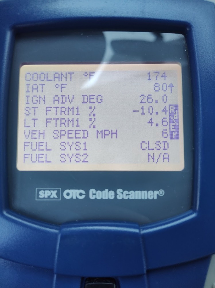

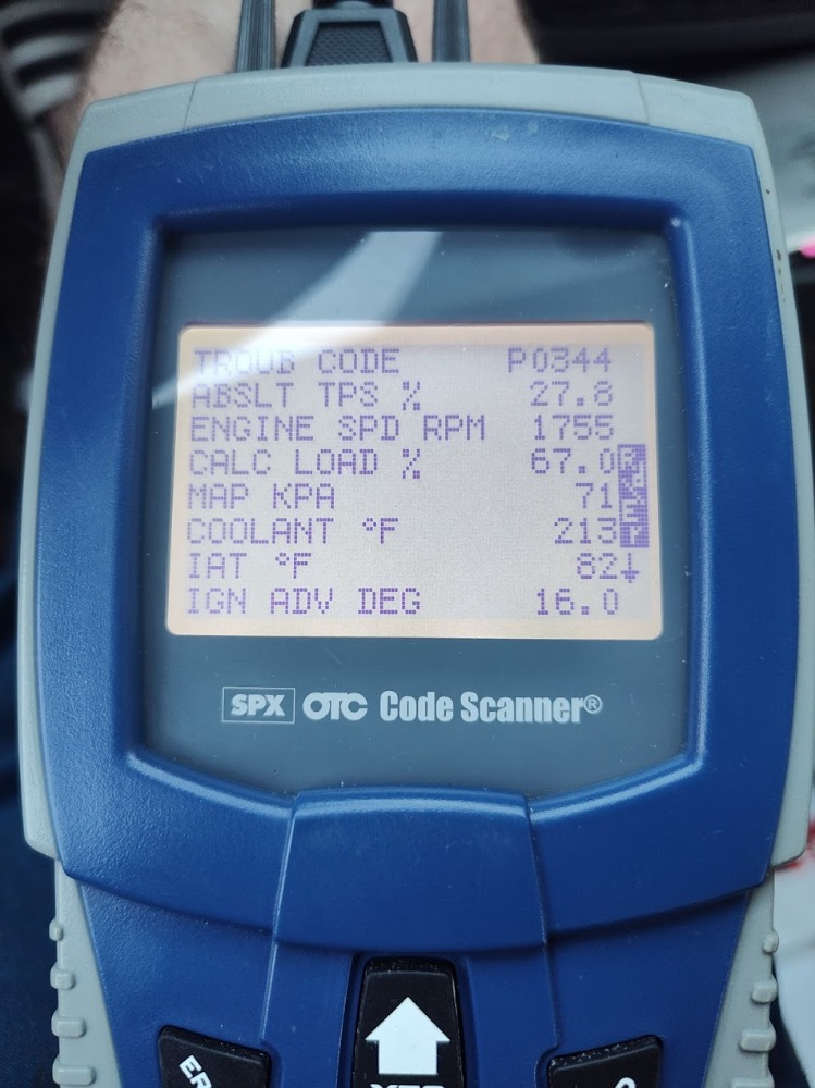

1 year 11 months ago - 1 year 11 months ago #68015 by jay123
I've taken this to a few shops and they can't find the issues after installing the new EGR and Cam Pos. Sensor. Please help! Thanks

1 year 11 months ago - 1 year 11 months ago #68077 by jay123
Anbody? Changed the EGR & Cam sensor only to have the codes come back upon the first road test. car misses and barely accelerates with like a jolting and thunking...You know anything about this?

1 year 11 months ago - 1 year 11 months ago #68865 by Monde
If you had a scope, you could scope the sensor to see if you have a square wave with no glitches. Is the connector free of corrosion or secure? No bent pins?  Someone and I were chasing an intermittent issue that turned out to be from corrosion. Paul always cautions us on bad cam setting up crank sensor code and vice versa. Intermittent problems are hard to diagnose. When you get the code, does the van crank and not start?

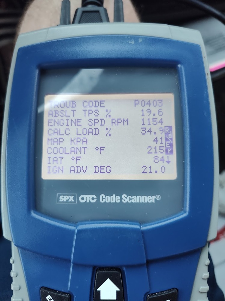

1 year 11 months ago #69650 by jay123
yes it runs just like crap as soon as I put it in drive and start slightly moving front after clearing the codes it will go basically into limp mode. However, if I clear the codes once every 2 or 3 times it will run perfect and only the EGR code remains. weirdest issue i have ever seen and been a backyard mech for 3 decades. What do you think I checked almost everything.

1 year 10 months ago #70498 by jay123
yes there is a po344 and po403 with both also pending so 4 codes total. I unplugged the cam sensor today and the van wouldn't even start with a PO340 code...then i unplugged the cam sensor again and plugged it back in with the same codes popping up 344 & 403....i think the harness from the van might be bad?

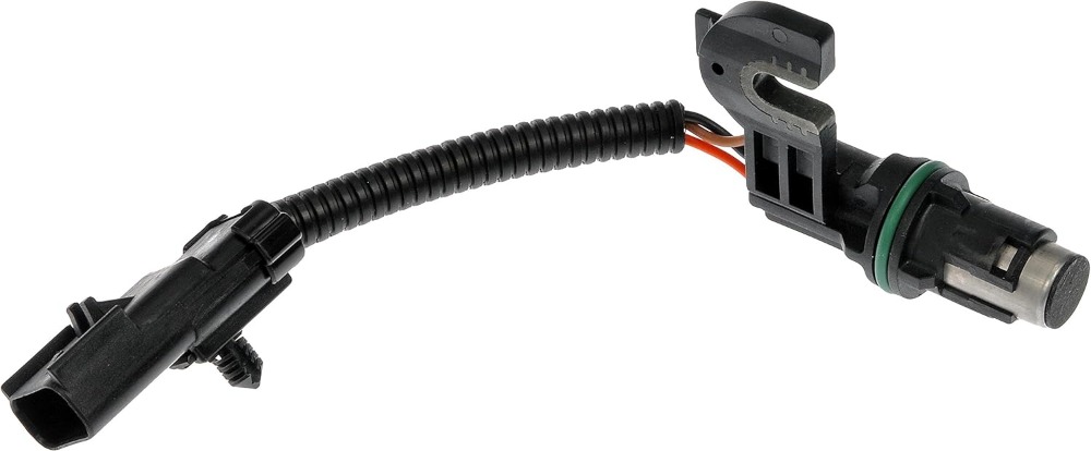

1 year 10 months ago - 1 year 10 months ago #73579 by jay123
there is some little spacer thing on the end of the new sensor that was blocking the signal and that's exactly what it was aftermarket parts have different tolerances...the amazon cheapy one was wrong...the dorman was wrong .. however a standard brand cam sensor fixed it...$237 to find out but, who the **** knows about this stuff since it's not on the internet or in any dodge manuals...im assuming you had an issue like this before lol?

1 year 10 months ago #73588 by Monde
The sensor had everything it needed to work, but didn't. Therefore, it had to be replaced. Glad that it is now fixed. Thank for the update, though.
