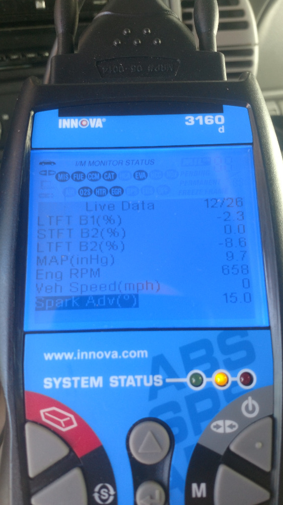

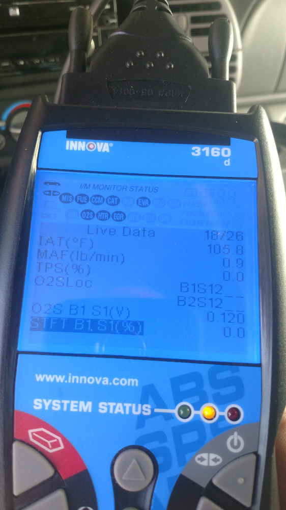

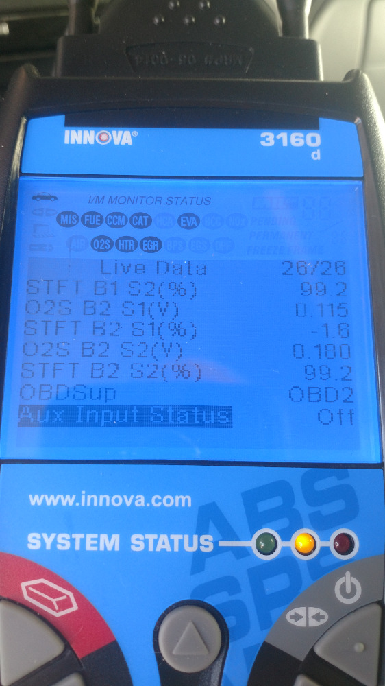

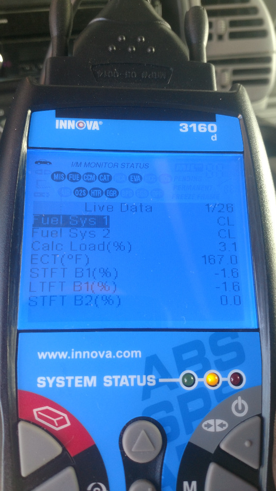

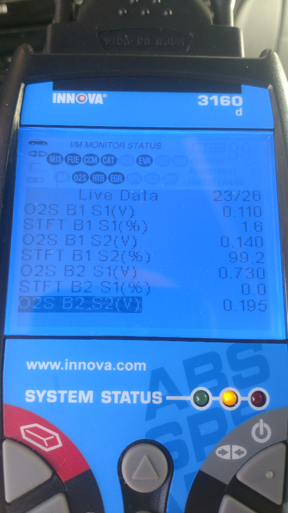

So I'm using way more fuel than I should be in my Tahoe. I went from 15-17 mpg/hwy down to 9 almost instantly.
I did a RT data with my Innova 3160 D which has the OBDII, SRS, ABS abilities, so it not a harbor freight cheapie.
i864.photobucket.com/albums/ab205/docsgs...3105_zpsqt2ejp9o.jpg
i864.photobucket.com/albums/ab205/docsgs...3608_zpskefpj5gm.jpg
i864.photobucket.com/albums/ab205/docsgs...8046_zpsu86ahkbj.jpg
i864.photobucket.com/albums/ab205/docsgs...3454_zpsebftjdpm.jpg
i864.photobucket.com/albums/ab205/docsgs...2368_zps3ksly0xg.jpg
These are my numbers. What I want to know is, what are normal STFT and LTFT numbers for a 5.7 vortec with less than 70K on the motor.
It has a rough idle, I tried the IAC valve and it didn't make a difference.
I am showing both bank sensor 2s at 99%, but can't figure out why it is so high with all my other numbers looking ok.
I have changed out the CC twice (now it has a complete flowmaster system from the manifolds to the exhaust tips), the O2's twice, Distributor twice, Fuel pump (it needed it anyway), MAP, MAF, plugs, wires, coil, ECM, injectors, I have no SES light on, and compression test is all cyl are within a couple of lbs, all being above 100psi. the engine doesn't knock, and it recently started to use a little bit of oil, maybe 1 qt every 5k miles. I only use Mobil 1 5/30 synthetic and WIX filters.
I am at the point that if I don't figure it out soon, I am going to invest in a gallon of kerosene and a book of matches!!!:( :( :(
Can anyone see what I'm not? It's frustrating because I really love my Tahoe, but cant justify spending anymore money on it.

I am learning here as are most of us are but I see bank 1STFT is 99.2 vs. bank 2 STFT is at -1.6. Not experienced with your scanner but at a glance, this looks suspect. Can you confirm these readings?

Those trim numbers sound weird, I've never encountered a fuel trim of 90% on a 98 Chevy. (I think the highest I've seen is 25%-30% correction. This is usually well within the threshold of code set criteria, so I would expect a CEL).
Typically, we add the LTFT to the STFT to get an idea of total trim. If this number is +/- 10%, it's considered to be in the "normal" range. Fuel trim will vary with engine load and rpm as well. It's useful to check at idle, 2500 rpm and at cruise (if safe to do so).
If the o2 sensors are pegged at over 0.9v, they're telling the PCM that the mixture is rich, and I would expect negative trims to counter this.

Those b(1-2)s2 numbers are a default for no input on cheaper scan tools they don't mean anything and you can ignore them . I assume all your readings are at idle that's likely not where your consuming to much fuel have an assistant road test while you monitor live readings at a steady throttle and post back the results
