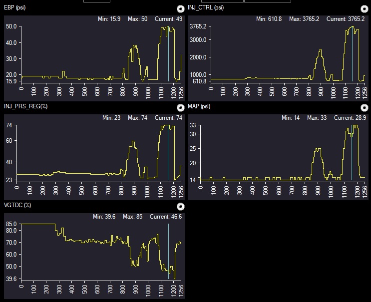

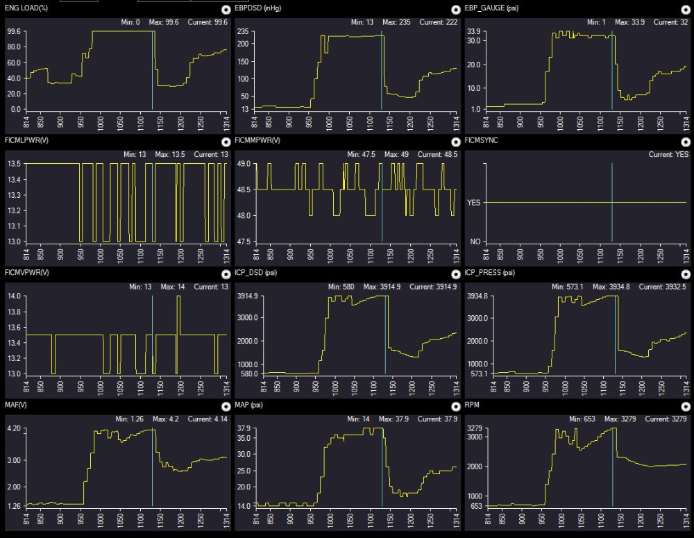

This Super Duty came in with low power when cold complaints, underboost AND overboost codes. :blink: :silly: It never got cold enough outside to reproduce the low power thing, but I did get it to buck/miss once while at WOT:
www.scanshare.io/share/_3s4NtV1NUaO6HCQ7Zp0tA
I kinda suspected a VGT issue based on the codes, but what I need help with the most is understanding the data. I may be seeing this truck again once the seasons change...
So, questions!
1.) Is the EBPDSD PID always shown in inHg? :huh: The highest value see was 235 inHg, which translates to over 100 PSI. This has got to be a scanner error, right? If you move the decimal place up one, you get 23 inHg, which is far more reasonable.
2.) If the above is true, then the desired EBP is around 12 PSI, and we're way past that in this capture. Is this EBPDSD thing BS, or am I looking at an issue?
3.) Can I use the MAF and Engine Load as a good measure of engine breathing in this situation?
Thanks! :cheer:

Also answered one of my own questions while reading about Engine Load. From the SAE document defining Load:
SAE wrote: Compression ignition engines (diesels) shall support this PID using fuel flow in place of airflow for the above calculations.
Welp, that answers that. NOT an indication of airflow.

9 years 2 months ago #12135 by Ben
Replied by Ben on topic Re:Need some Powerstroke help!
Hey Tyler what is your frpr % on hard acceleration. Also is cylinder balance test working on your ultra?
  • Tyler's Avatar Topic Author
9 years 2 months ago #12138 by Tyler
Replied by Tyler on topic Re:Need some Powerstroke help!
Ben wrote: Hey Tyler what is your frpr % on hard acceleration. Also is cylinder balance test working on your ultra?
Hey Ben! I didn't see a FRPR PID, but I do have INJ_PRS_REG%. Same thing, or no?
www.scanshare.io/share/1M3v5ZihC0KhD7UKQ2ymGg
I think the cylinder balance test works? But I didn't run it. :blush: Missed opportunity, in retrospect.
9 years 2 months ago #12141 by Ben
Yes same thing and looks good . For reference 85% is its max so if you have 1 going that high you likely have excessive leak In the hpo system such as injector O rings or dummy plugs and an air test is best way to find it .also according to your map your hitting 20psi so that is good to for a non tuned truck
9 years 2 months ago #12142 by Ben
Use the balance /contribution test whenever you can .. it hasn't been working on my ultra for a while now I get some error or the other ....

9 years 2 months ago - 9 years 2 months ago #12147 by Tyler
Ben wrote: Yes same thing and looks good . For reference 85% is its max so if you have 1 going that high you likely have excessive leak In the hpo system such as injector O rings or dummy plugs and an air test is best way to find it .also according to your map your hitting 20psi so that is good to for a non tuned truck
Nice! B) This is good stuff to know. I'm assuming I'd see a corresponding difference between injector desired and actual pressures if the regulator is going above 85%?
Between you and the videos Ro-longo posted, it seems like all was well during my test drive, and whatever was causing the P0299/P0234 didn't show up. :-( Oh well, hopefully I'll have another shot at this later this year.
The first video was awesome! :cheer: That dude wasn't even interested in EBP_DSD, and his readings matched mine at WOT, so I'm gonna ignore that PID until someone tells me not to. :lol:

9 years 2 months ago #12159 by Ben
Replied by Ben on topic Re:RE: Re:Need some Powerstroke help!
Tyler wrote: I just realized that the dude in those videos is dead. :-(
Yea that's too bad he knew a lot about those powersrrokes . Icpr won't go above 85% so think of it like this 85% actually translates to 100% so if your hard acceleration and your seeing low 80s it's not long before it's going to max it , yes you will see the difference in your commanded vs actual pressure if the leak is bad enough but your icpr will be pegged at 85% during that time , this is very useful in crank no starts and also give you an idea of the fuel system performance that the actual vs commanded won't. I think I'm on 16.2 but I'd have to double check that
