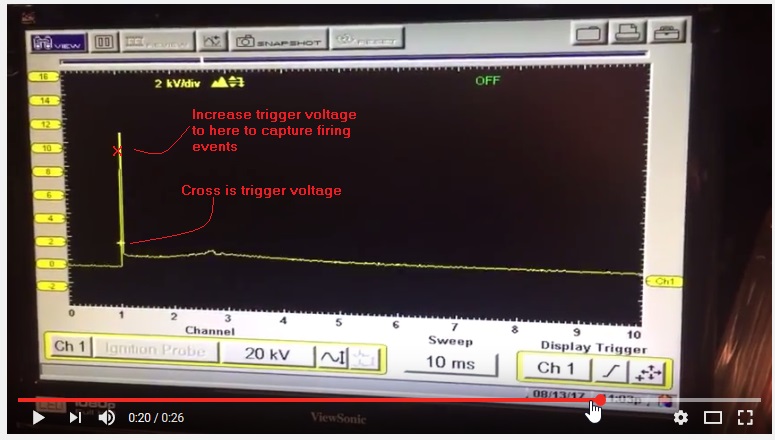

Hi All,
I have checked several cylinder ignition wave forms and they all pretty much look like this. Is this an acceptable waveform?
Waveform Video

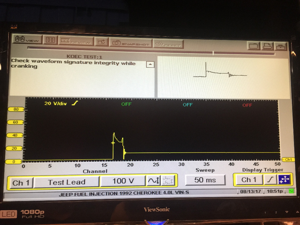

Also, this is the Coil negative terminal that is back probed to check the ignition signature. This doesn't look like the signature example provided by the MODIS. What are your thoughts about this?
Steven

9 years 2 months ago #12202 by Andy.MacFadyen
Replied by Andy.MacFadyen on topic 92 Jeep Cherokee 4.0L - Ignition Waveform Analysis
The captures on your video aren't stable enough to be useful you can fix this by moving the trigger voltage setting upwards.
Also if you clip your ht probe to main coil to distributor HT lead and slow you time base (trace shows a longer time displayed on screen) you can capture a spark parade of 6 cylinder this is called a "spark Parade"--- which is very useful for tracing misfires. With a spark parade you look for a cylinder that the spark voltage pattern looks different from the rest ---- what ignition waveform guru Jim Morton calls looking at the forrest before you look at the trees. If you see a spark that dosen't fit in then go in and look at the individual spatk voltage.
Unfortuneatly I can't view your photobucket photo so can't give you any opinnion on that you can however post jpegs directly on the forum using the attachments button

9 years 2 months ago - 9 years 2 months ago #12214 by waxerk5
Thanks Andy. I will modify the trigger to get the firing event captured better for single cylinder waveforms.
On the parade capture, I did try that and it only gave me 4 firing events. I thought I was doing something wrong there. Perhaps I was "zoomed in" too much with the shorter time base?

9 years 2 months ago - 9 years 2 months ago #12272 by waxerk5
First off, thank you guys for helping me to figure out how to better use my MODIS.
I have taken a video of the 6 cylinder parade pattern and I see 1 issue that I am concerned with.
Notice that the spark KV jumps randomly across all 6 cylinders at idle. At increased RPM, it goes away. During a snap, it also goes away. But at idle, the spiking spark KV event is taking place.
Is that a normal event or is there something wrong here with the ignition system somewhere?
Thanks guys.
Last edit: 9 years 2 months ago by waxerk5.
9 years 2 months ago - 9 years 2 months ago #12277 by Chad
The ignition system looks fine. I suspect you are running a little lean. An unstable (bouncing up and down) spark line is an indication of a lean density condition. The leaner the mixture in the cylinder, the more KV it takes to jump the air gap. Ideally, you want to see about 1.5 KV on the spark line with a duration of at least 1.3ms.

9 years 2 months ago - 9 years 2 months ago #12281 by Andy.MacFadyen
Looks fine, you have take into acount no two firing events are the same especially at idle where the engine computer will be making continuous rich-lean-rich-lean adjustments to the fueling.
